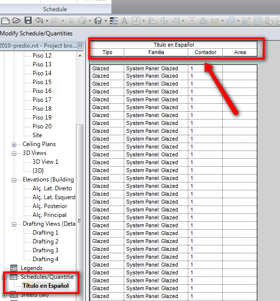

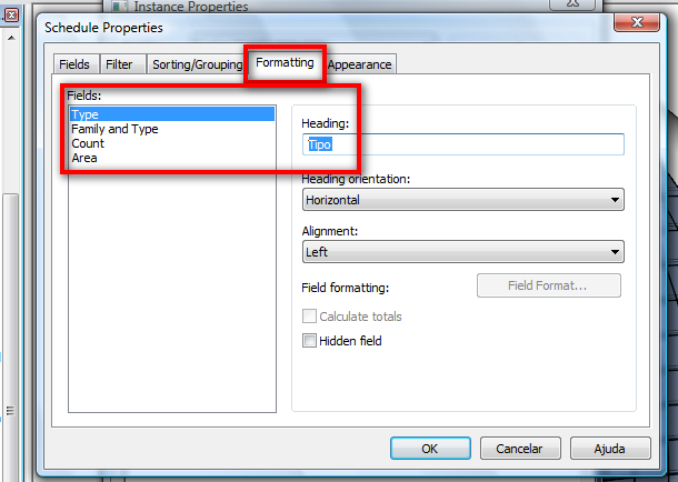

How can I change the language of my Revit Files, I have Clients in Mexico and they don't understand English.
*The title of my schedules, etc.
Wed, Jun 10, 2009 at 4:57:18 AM | Revit Building
Joined: Tue, May 22, 2007
5921 Posts
4 Stars: 205 Votes
In shedule properties, in formating you can change the name you want, OR in the shedule title pick then change what you want....
