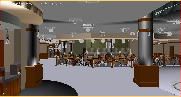

awesome!  alabaster...you are the man!  I knew that option was in there somewhere.  It is nice to not have to continuosly reload my content anymore.  Unfortunately, I re-exported the fbx and it looks about the same materials wise.

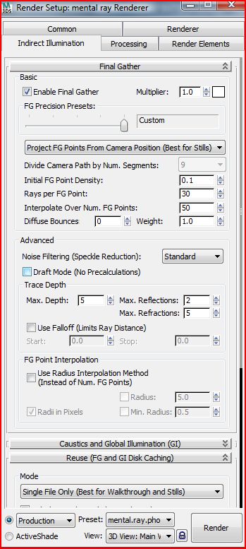

What presets do you normally use as a starting point?

yeah your scene appears that way becuase the bitmap (adsk) shader does not display the material map. Like I said before I usually replace the bitmap (adsk) with a normal bitmap and use the same texture map. That way I can see the scale.
Your FG settings are fine for draft renders, for that interior I would also set up a global illumination without FG. Once you have a good lighting solution you can burn both FG and GI to file and save a ton of time.
Also try messing with hardware acelleration so you can use the directX for your graphics card to get a more defined look to your viewport. it will display all your lighting and shadows in realtime
