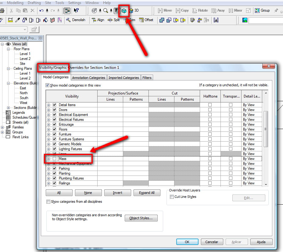

Hi guys I'm noob but i need some help. I have been making freeform objects with mass for awhile, but i learned that mass doesn't like to show up and i want a solid object. I learned about the create tool in modeling, and it makes things from already existing families (i presume?) The only probelm with this is that there is no stairs option to select from in the box. I don't like the stairs option in revit because it doesn't fill in the area underneath the stairs. Can someone help me out here?

Ok, 1)- to "show" the mass or you go to VG in that view and you turn ON the mass or in the Menu bar you have the icon "Show mass", you can turn on/off but my advise is, use only the "Mass" to create the shape/form you want then you can apply slabs, walls, roofs and curtains systems.

1) oh that is cool. I knew how to show/hide but that is perment. Saves time
