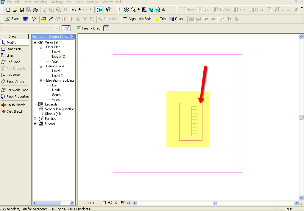

Wed, Jun 3, 2009 at 6:17:49 PM | Modifying Openings in Floors
erland73
erland73 Avatar
Joined: Fri, Sep 7, 2007
738 Posts
4.5 Stars: 85 Votes
Yeah, I agree with WWHub......this way (see attached)
