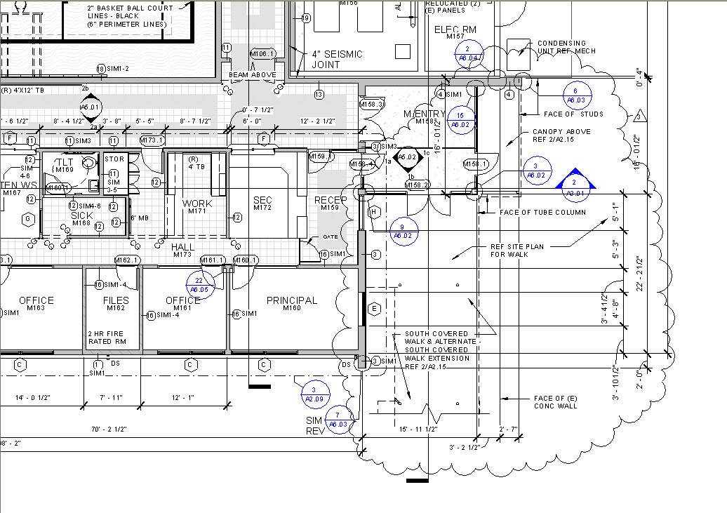

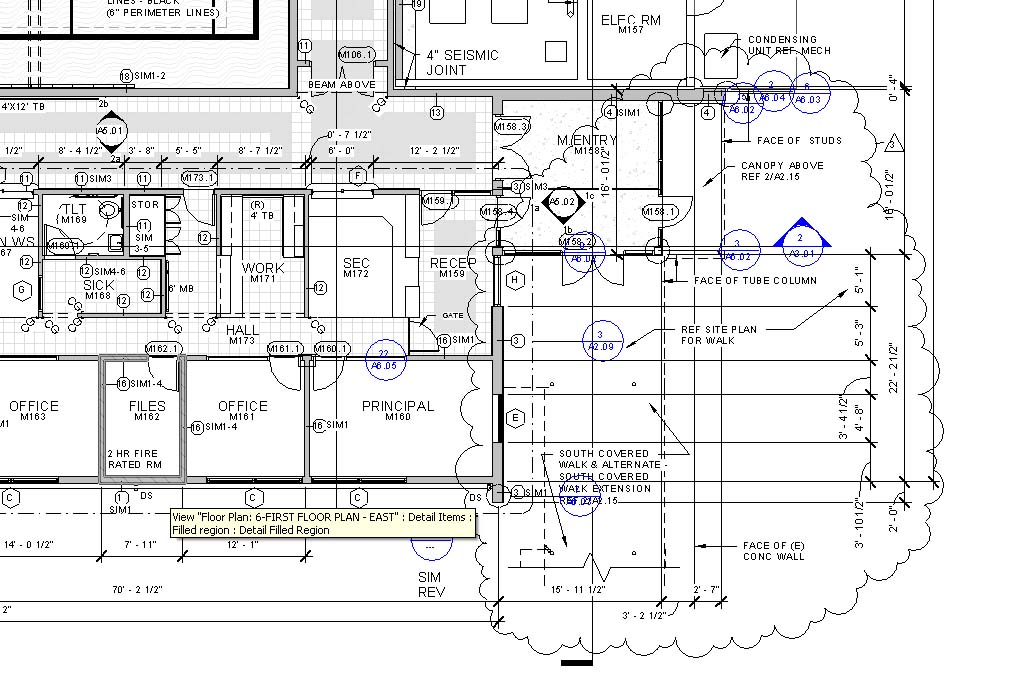

I seem to be having a problem.  I'm working in 2009 and have a rather large file. I'm working on creating addendum items and when i go to duplicate the view as a dependant it shifts all my detail marks.  It seems like it takes the bends out of them. I have attached a pic of the correct view, then what happeneds when I duplicate it.  Please help... I don't know what to think.

Heres the right attachements.

There is a much better way of doing addendum's than dependent views.
First - archive your file for the record.
Follow this thread to create a sketch overlay family.  This places right overtop of your sheet.  You edit the view - bubble it & tag the revision - then place this sketch which masks all except what you want to show.  After printing, you can discard the sketch & your file is up to date.
http://forums.augi.com/showthread.php?t=53492&highlight=addendum
This works great ... it will take you awhile to figure out how the family works so that you can modify it with your titleblock.  We use both 8.5x11 and 11x17 sketches.
