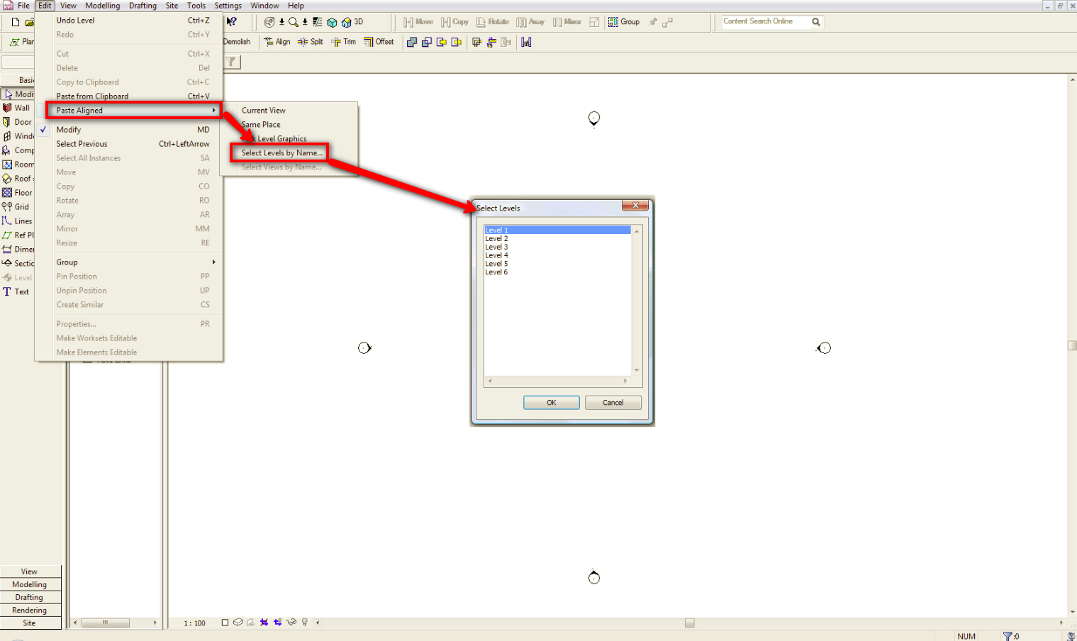

I have a dormitory project and the floors area identical, is there any way to copy the floors up or do I need to redraw them.

Copy everything to the clipboard and paste aligned by picking the levels.

Yes, see the attached.....

worked as discribed, thanks for your help
