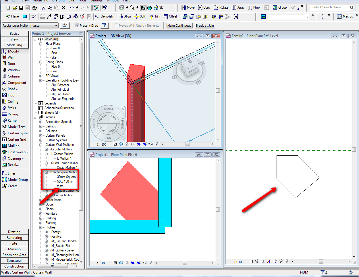

How did you get the corner mulllion like that to begin with? I am struggling with this.
Trying to create something like this...
Wed, Aug 2, 2017 at 1:57:54 PM | Corner Mullions not extending glass to meet
You can vary the shape of mullions by loading new mullion profiles into a project. Also, you can create a custom profile.
Read ThisAnd This
You will need a left and right.
I believe you may also find some already made in some of the CW's available on Autodesk SEEK.
