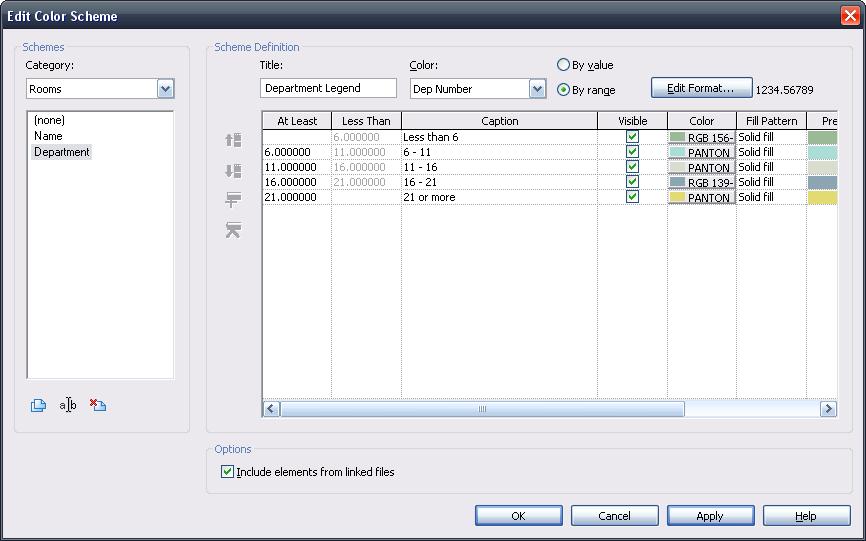

color scheme by range? how to set it? only by value is available

If the parameter you're using for color scheme is a 'number' parameter, then you should be able to apply scheme by 'range'.
See attachment.
