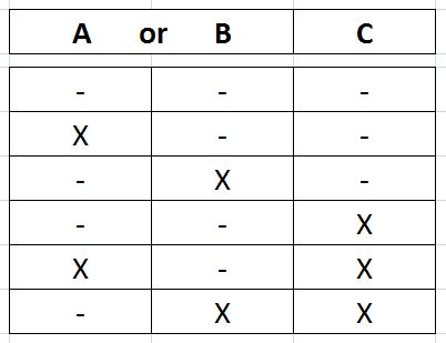

For instance, I have my room schedule, for which I'd like to add accessibility parameters: wheelchair (A), wheelchair with roll-in shower (B) and hearing impaired (C). I've attached a schedule of all possible configurations. A room can only be A or B (or nothing), never a combo.

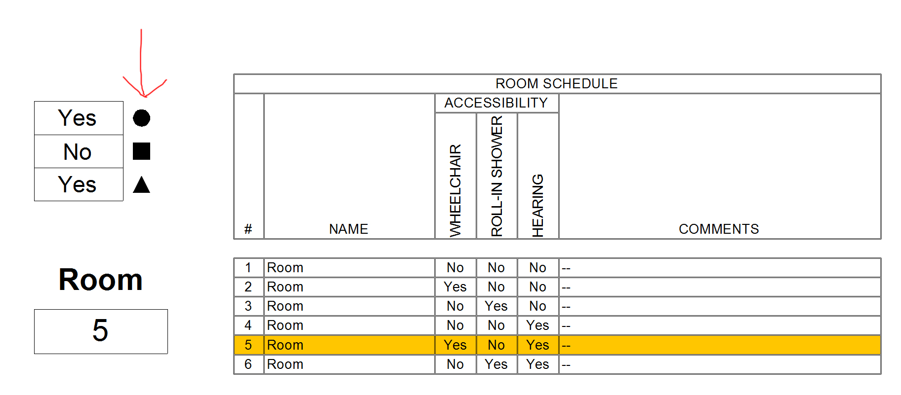

Ok, so no luck so far.
I created a tag showing the Yes/No Parameters based on my criteria --that was the easy part-- but now i want to set the visibility of the symbols (currently represendted by the dot, square and triangle) based on those parameters. The tag showing Yes/No/Yes would only show the symbol, but that's just a matter of deleting those labels.

Mon, Jun 1, 2009 at 6:58:14 AM | automatic tag
Sorry - there is not way of doing this at this time.
