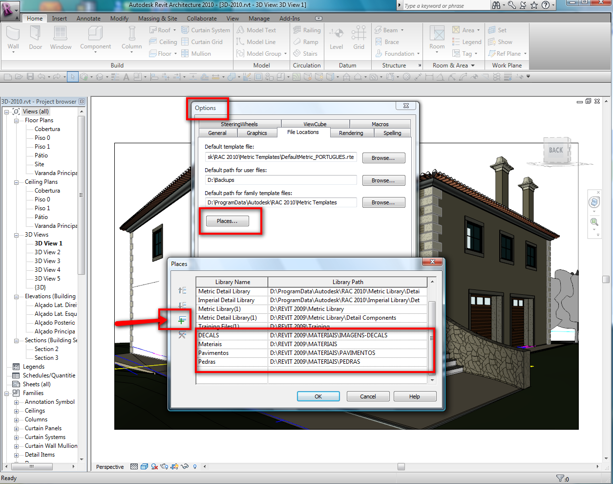

Revit loses the link to my image maps every time I save a file or fix the link on another material. This means that there is always at least one material missing when I render. It thinks the image map should be in the folder that I most recently accessed. I made sure to use the "apply" button when I repair the material, but that doesn't seem to help.

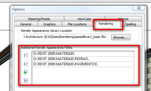

Yeah, add in the "Options" the folders  where you have your materials like you can see in the images attached...

I still get the error message for that second to last folder that I added. Do all my custum materials need to be in one place? Does it matter what the library name is called?

Just put the Paths and restart Revit..... That's all....
