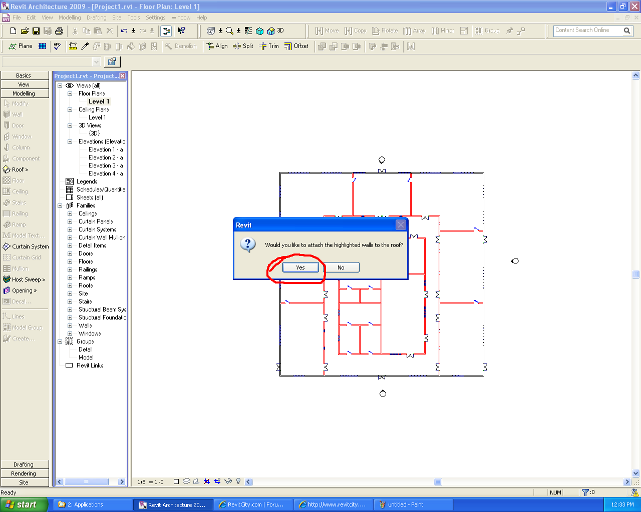

Hello, it's me again, and now I'm trying to make me a roof.
Attached is what happens when I try to create a roof by footprint.
I don't know how to solve this problem, but want a roof for this building...
 If you think I could make this roof easily some other way (not by footprint), and can explain it, then please tell me that, too.  Thanks agin!

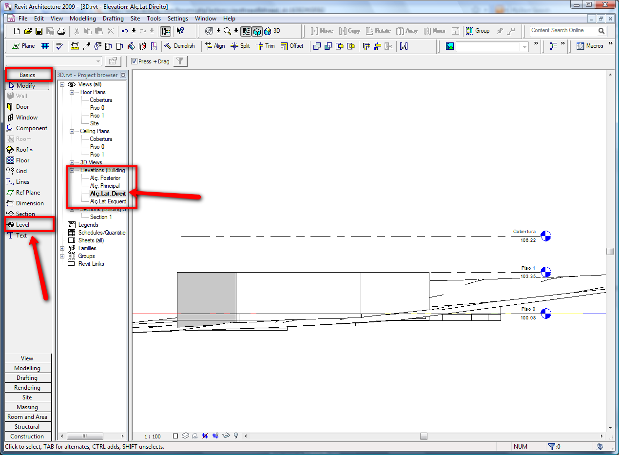

The problem is, you have ONLY one level, you create your walls, doors, windows and so one in the "Level 1" AND YOU CREATE THE "ROOF" in the same level, Create a new level in the top of the walls and create your roof in that level...

Go to an elevation view and in "Basics>Level" create the levels you want...
