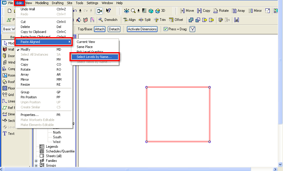

I'm making a building and I want to have the same as level one on other levels, but it takes too much time making it step by step, so, I want to know if there is a way to make it the same without wasting time??? you know like a tool to just copy it.. please help me with this... and I also would like to know if it is possible to have a single floor but with different finishes on each room??? if it is please tell me how..

"you know like a tool to just copy it.." , exactly kokicio23, copy/paste (see attached).

And once you have made the floor you can use the split region tool to divide the rooms up and then the paint bucket to apply different finishes.
