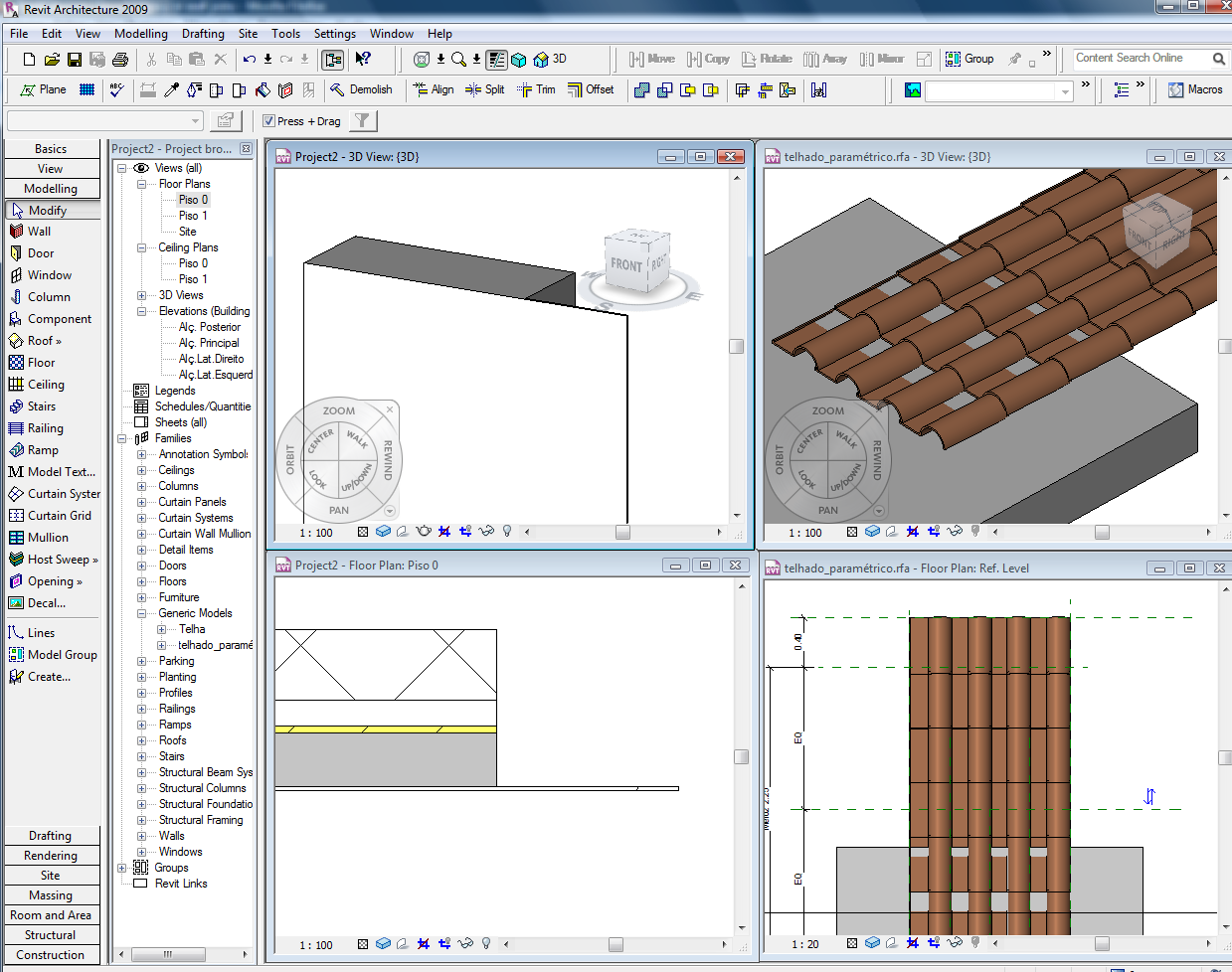

Are you sure they have "the same exact thickness and material."??? No matter if they have different functions or if they have different thickness or if they are into the "core" BUT they must have the same material....

the image you posted is exactly what I want.  I've done it before with varying thicknesses, and relationships to the core boundry (same material) and it usually always works.  yet sometimes this seems to happen.  sometimes with two walls, sometimes with a wall and a floor.  frustrating

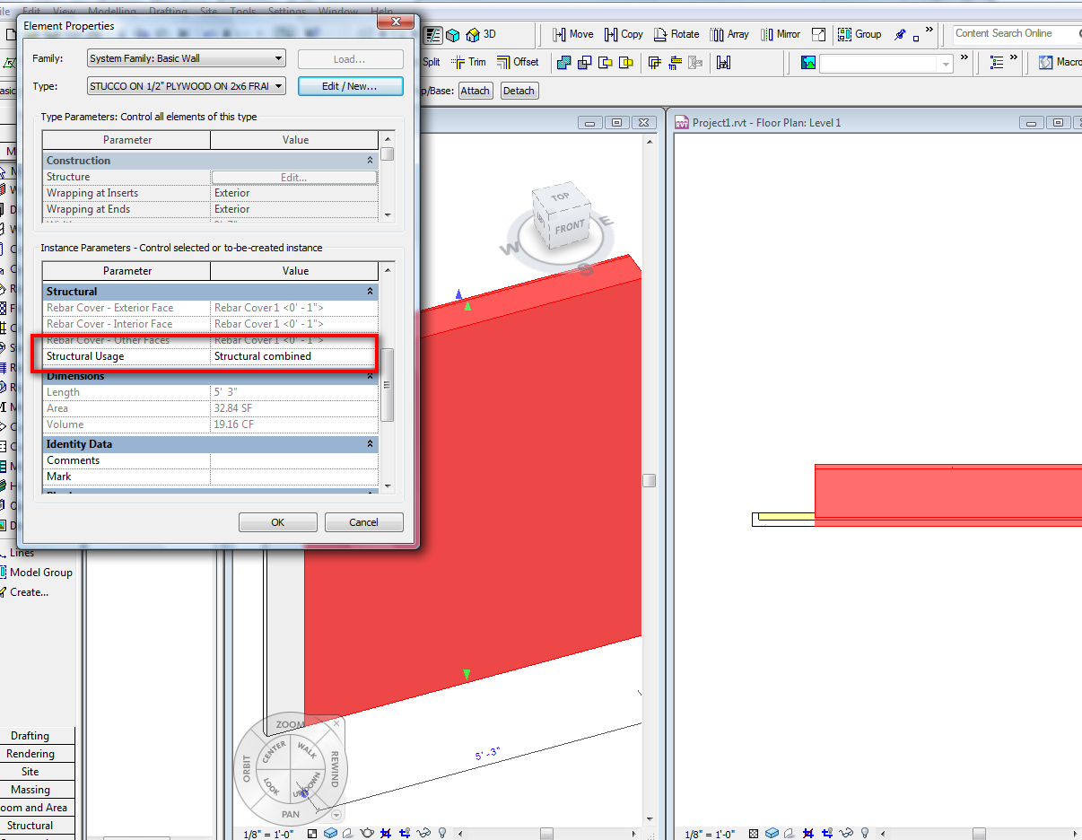

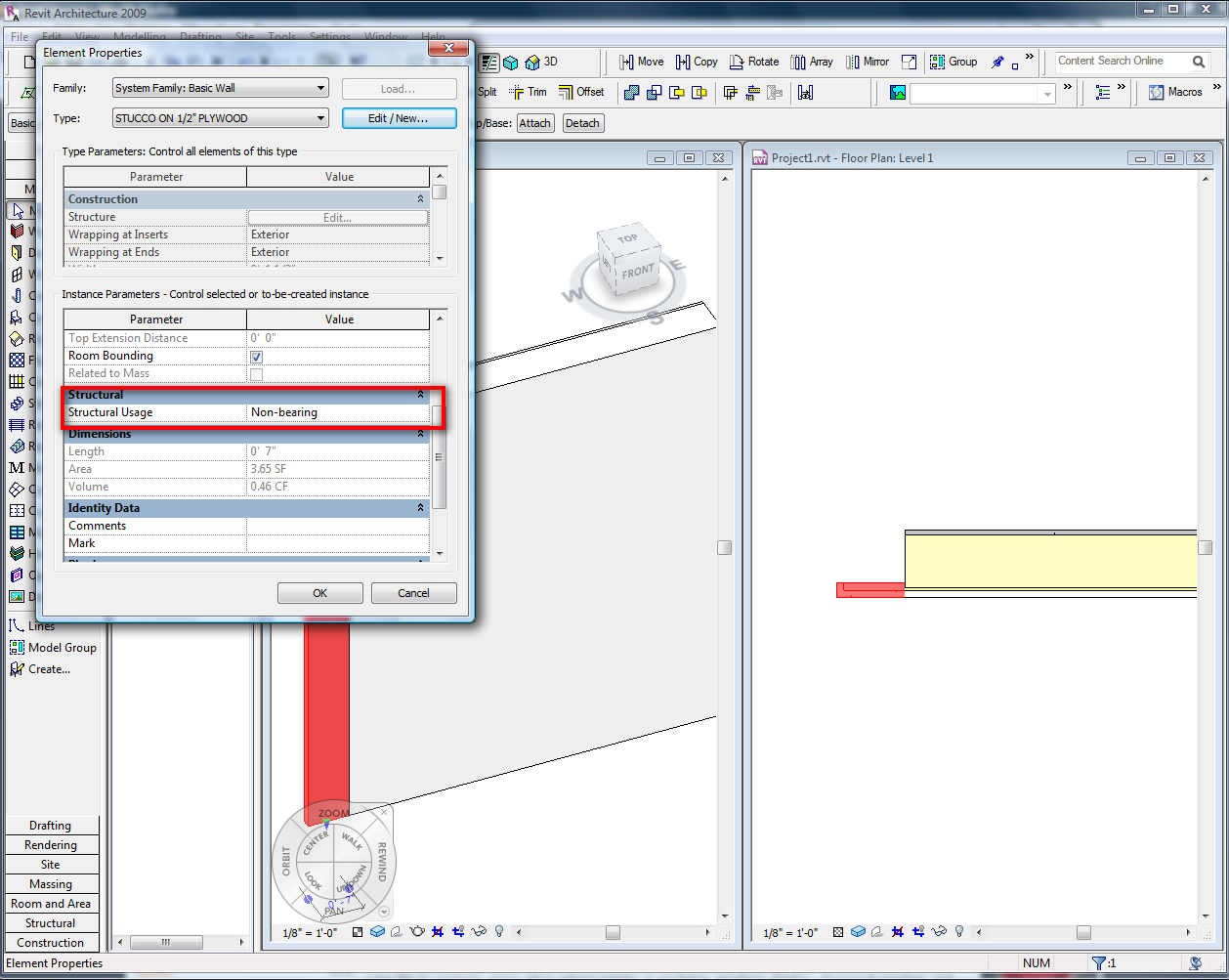

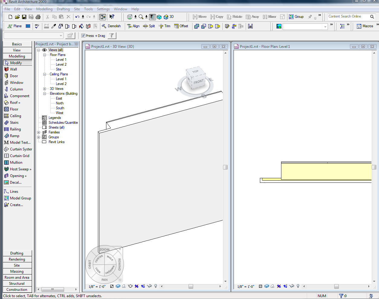

That's the problem "Structural Usage", put in the same Value and problem solved, see the images....

aaah. I was inputing structural elements feverishly at one point and I mustve been blowing through the warnings on bearing vs non-bearing..but yeah that solved it.  thanks!
