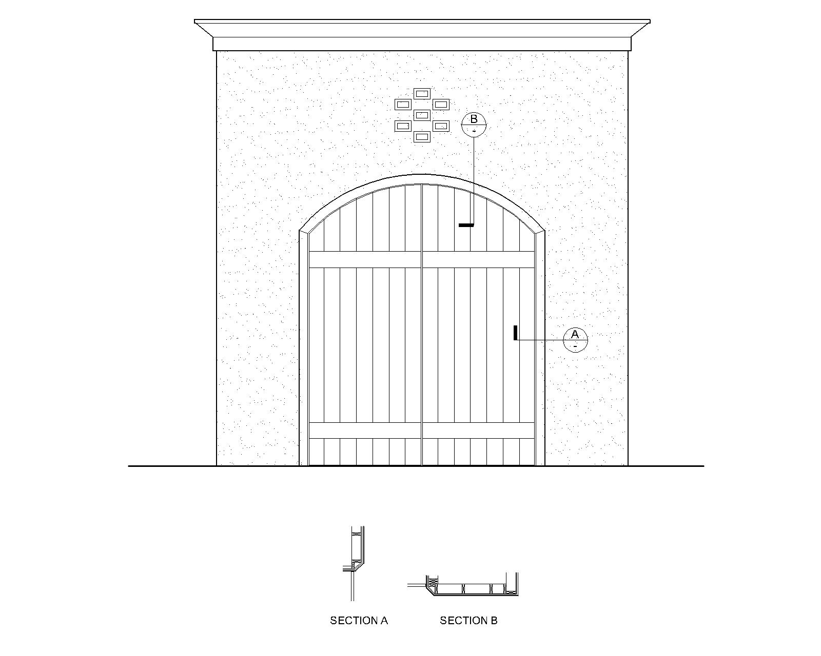

I've attached files showing an arch in plan, section and elevation. I can't seem to find a way to accurately model this. I can model a simple arch but not one with the bevel. Any ideas? Thanks!

Just apply a void sweep with the proper profile to cut the wall. See the attached file as an example. HTH Tom

How did you do that?
I know I'm a newb!
thanks for the help!

I took the cheaters way out to do this one. 1. Edit the wall profile to create the arch opening. 2.Go to "modelling" "create" choose doors, name the thing, choose "void form" from the left menu, then "void sweep" switch to elevation view, pick the plane of the wall, sketch 2D path (or pick path), finish path, sketch sweep profile (plan view would work), make sure you cut the wall with the void sweep (cut geometry tool) finish and finish. A more complex approach would be to build a family with the doors and void sweep all in one. Not for a newbie though. HTH Tom

Thanks man, that worked great! Surfrusty
