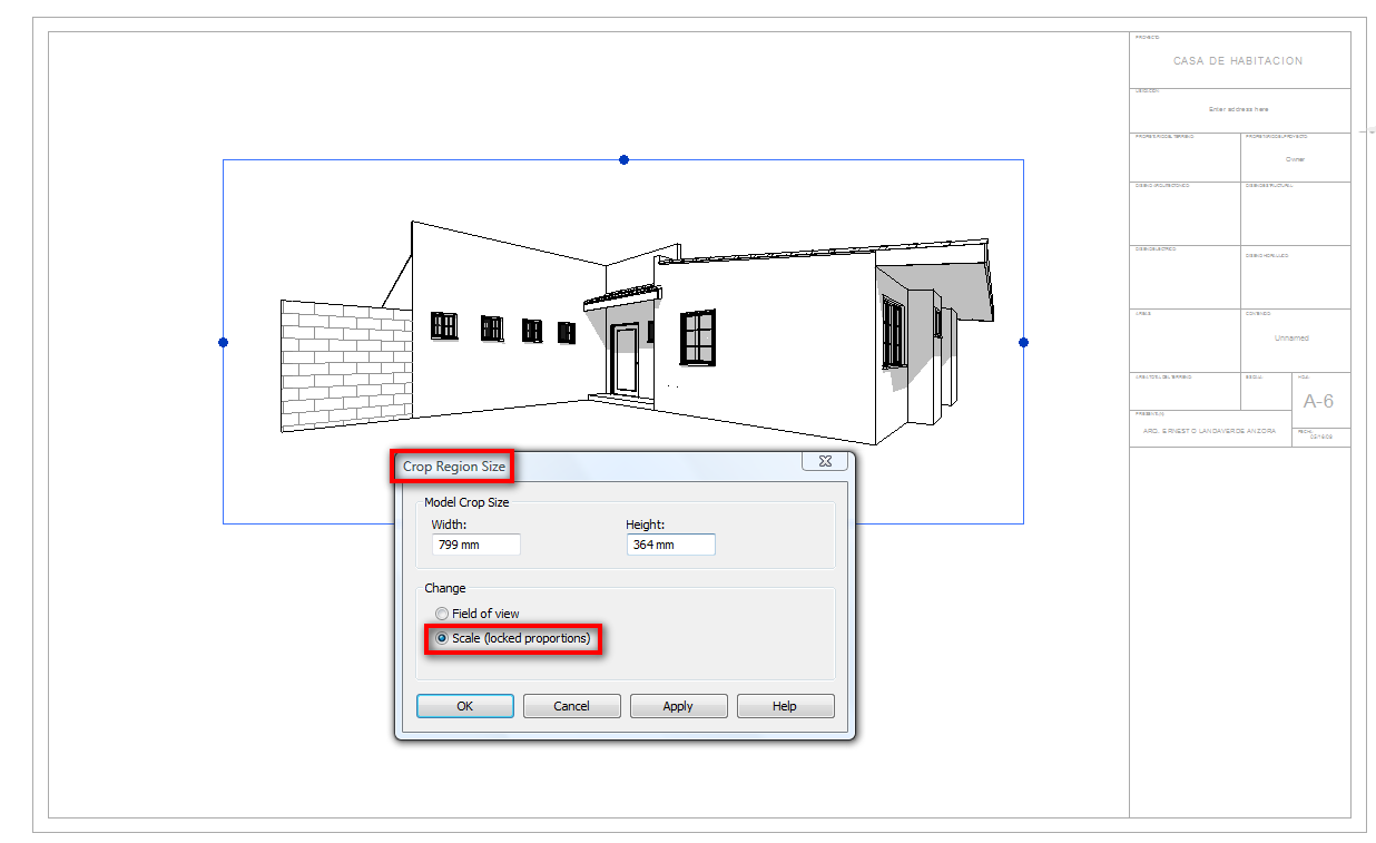

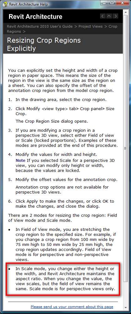

RevitStudent123, have you tried by picking the view and changing its size crop region in Scale Mode?...
BTW, it's not necessary to create a new thread everytime someone replies you, just click "Reply"....

If we read well his first thread ( http://www.revitcity.com/forums.php?action=viewthread&thread_id=16330 ), I think his talking about "scaling" a perspective view (but not rendered as I understand), that´s why I'm suggesting him to try by changing the crop region in scale mode, but RevitStudent123, you have to get us out of doubt.....
