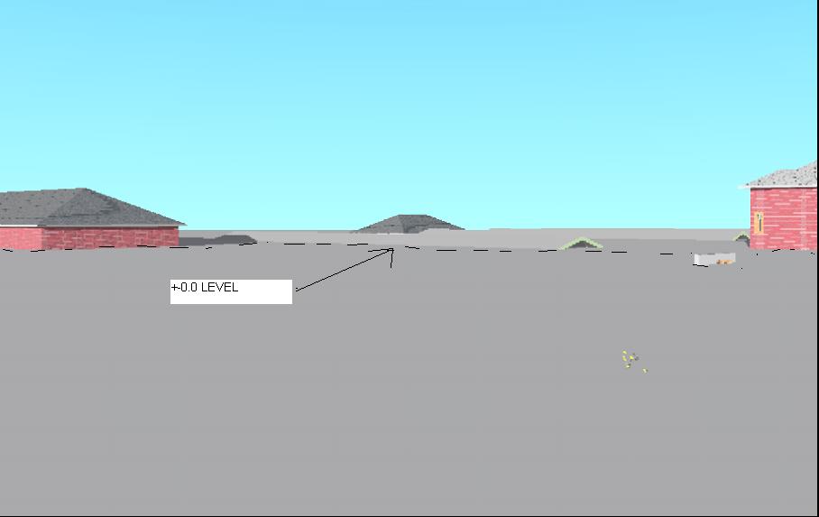

i can't have renders under zero level....THANKS FOR HELP Post edited on 2005-07-18 04:34:30 Post edited on 2005-07-18 04:35:06

Looks like you've got an automatic ground plane set too high in your rendering settings. Go to your rendering settings-->environment-->ground plane and adjust its level as necessary.

There are two places where ground planes can be set, one is by distance from x-y axis, one is by level (ie if you have a level at 0). Check out my previous post. http://www.revitcity.com/forums.php?action=viewthread&thread_id=1578
