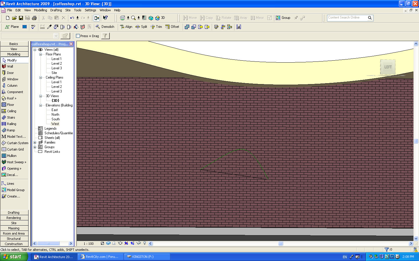

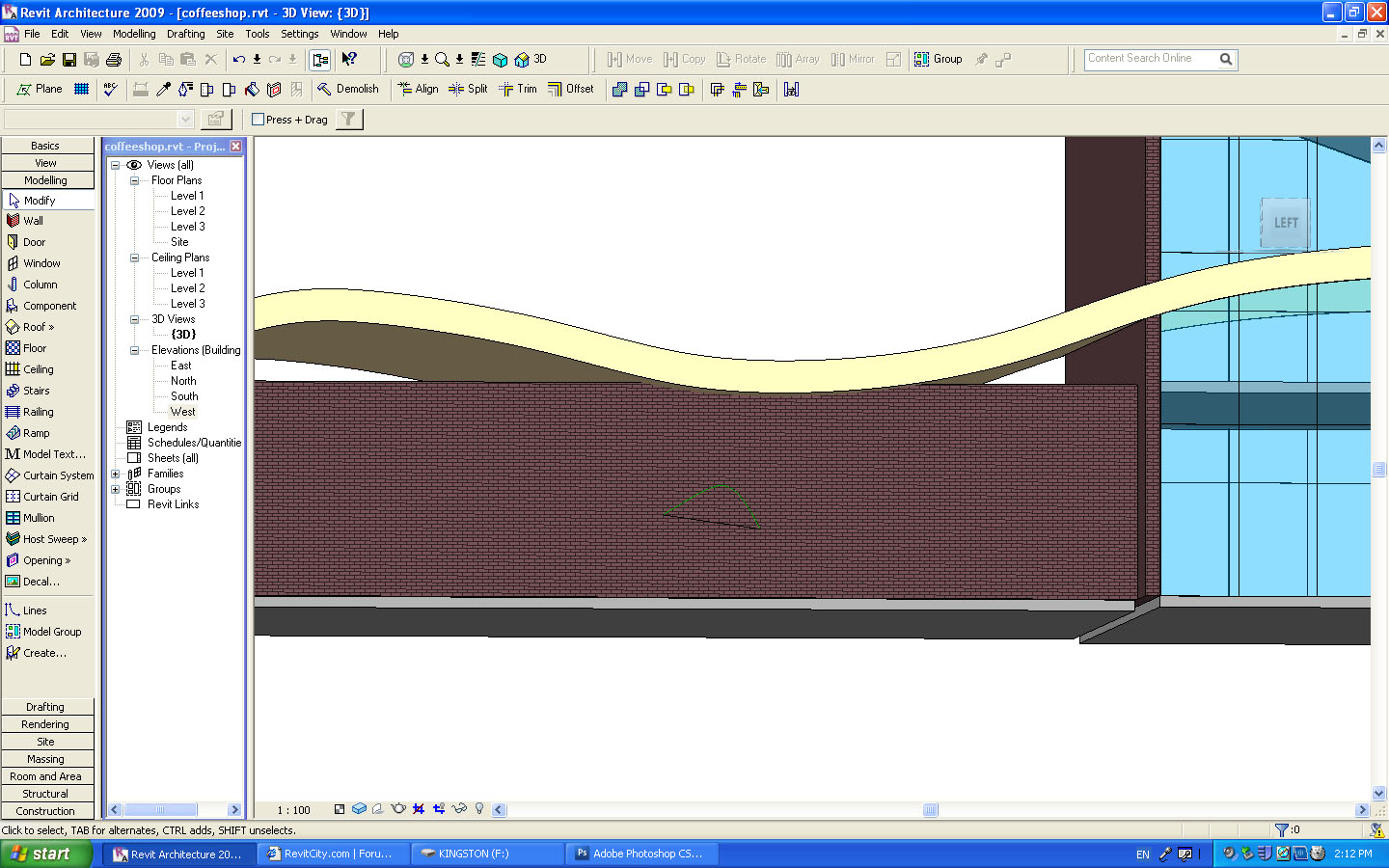

Thu, May 14, 2009 at 4:14:31 PM | Curved Sweeps?
brendanonstad
Joined: Wed, May 13, 2009
8 Posts
this is what im trying to do. the curved lines in the wall are what im trying to extend out of the wall.
