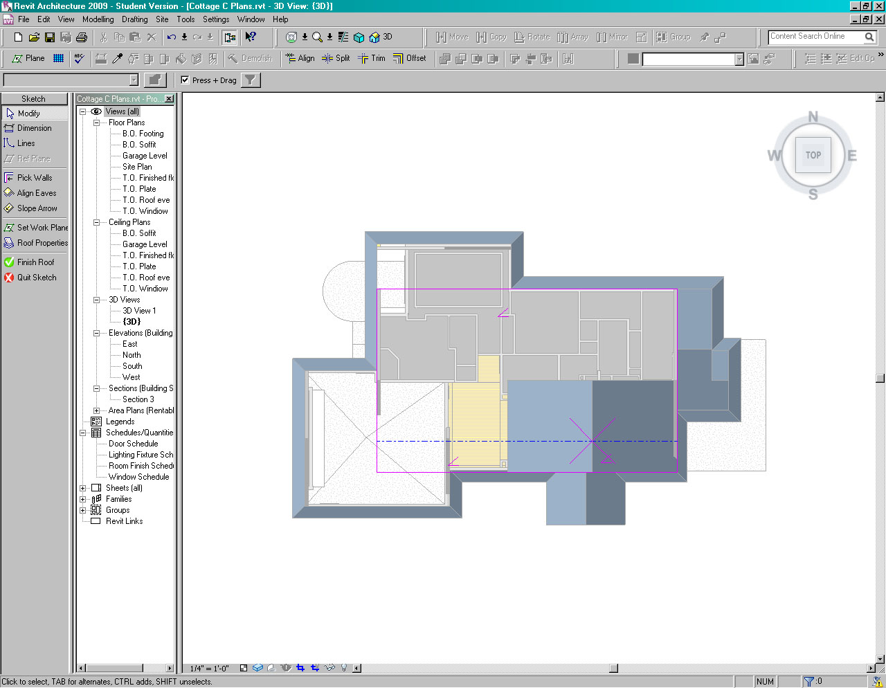

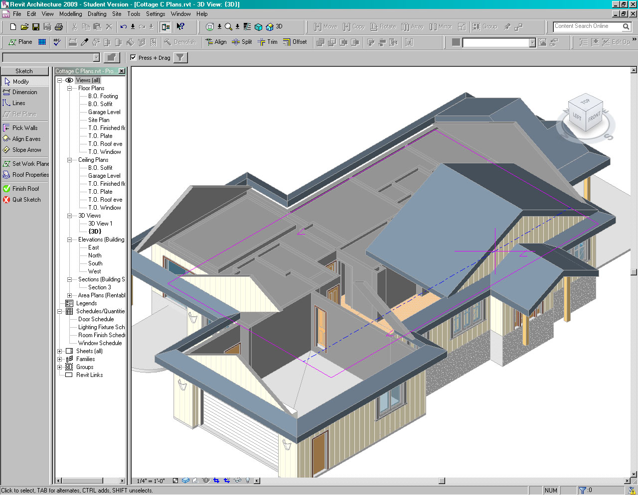

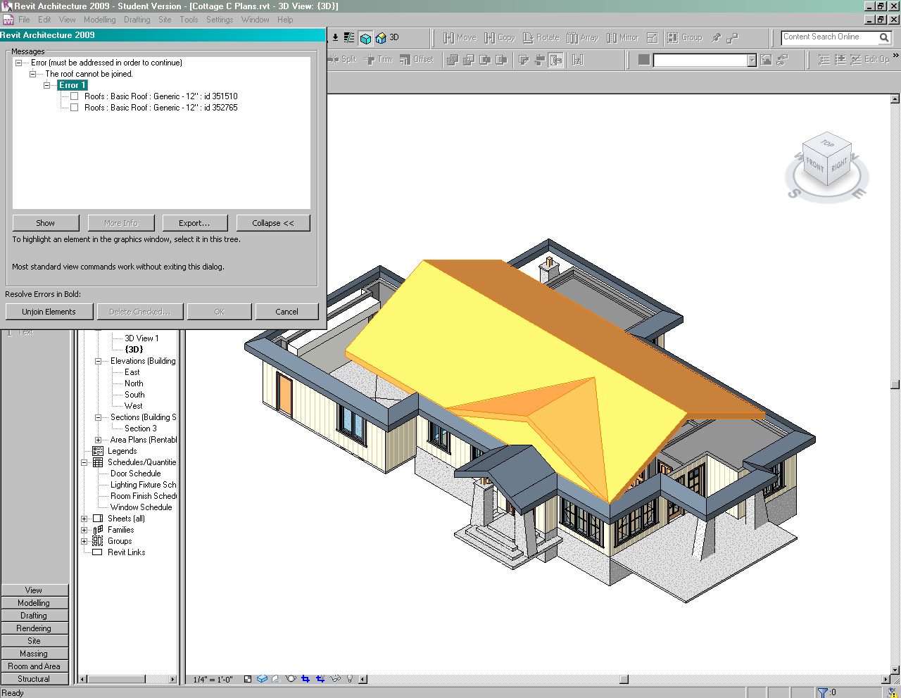

I am having issues joining two roofs, the error message that keeps appearing doesn't tell me what the issue is, and when I join them using th join roof command, the roofs do what I wnat them to do but it doesn't stick and I get the error message.  I have attached an image of my issue.

Rather than doing them as 2 separate roof sketches and joining them those 2 parts of the roof can easily be done as a single sketch.
  1. Where you want the gable, split the line into 3 pieces.
  2. So there are break points where you currently show the valley's.
  3. Then draw two slope arrows going from the valley line to the midpoint of the middle line (for the line you've just split into 3).
  4. Select the slope arrows and set their levels and falls appropriately to match the rest of your roof.
  5. Finish Sketch
This may be a little tricky to follow without a picture, I can't remember but I may have posted something on my blog about this some time ago or at least something in the forums.  If you can't follow or find it then please let me know and I'll post a screenshot.

I think I am going to need a visuial... I keep getting an error saying that the roof footprint can't be made, and I don't exactly know where to split the line because the far left valley is in the corner of the roof.

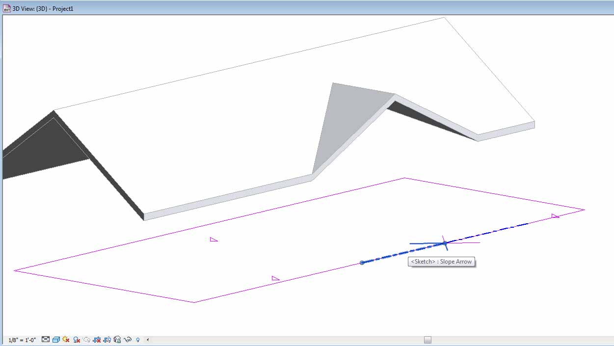

You give the gable its own manual slope arrows, like in the attached pic.  Slope arrows are more time-consuming than slope defining boundary lines, but more powerful.
There are breaks in the boundary which exactly match the lengths of the two slope arrows.
so break-break-break the boundary, and draw two arrows over the remaining segments.
