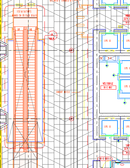

I am a student to study revit and would like to ask you something not to know. I am trying to draw it after down-loading escalator family, but i do not know how to change its parameter. It will be grateful if someone helps me after reading revit file and escalator file that i am going to load on the screen of the room
escalator in first floor

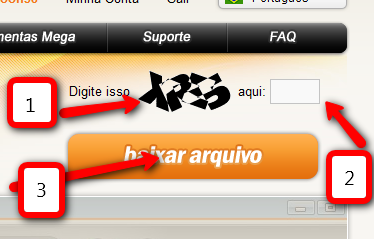

It's working, pick in the link then see the code (1), write the code (2), then pick in download (3)
You can see or save, you choose....

when using the internet in Korea, i think there is a problem in the network since internet sites do not open. I have a question. If one of family members download is there a fixed parameter and a non fixed parameter. If there is a capable escalator It will be thankful if you upload it.

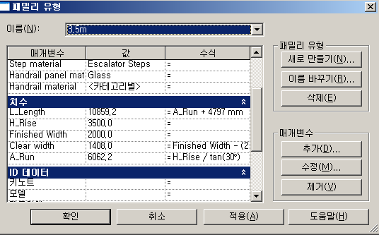

Can parameter of all downloaded family be changed? is my question.
i am so sorry for my low english skill.
i thought it could be changed. But i thought that maybe i can't find information for it. so i asked you
i clicked all icon. i think this picture is right. this right?(revit, korean version so.. only see number and english)

"Can parameter of all downloaded family be changed? is my question." - YES, after you insert the escalator into your project you can pick in that and go to options bar-properties and you can change those parameters (lenght, width, number of steps...), why don't you try???
