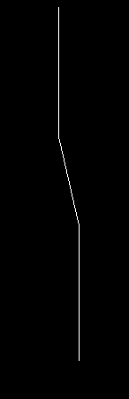

32th floor out side wall of building is curtain-wall.Some of them are slant curtain-wall
I wander  how I can  make these curtain-walls continuous and slant,like this
It'll be very thankful for you to answer me.
 Like this picture

the quick way, in that level, create MASS with the shape you want, then finish and apply "Curtain System"....
