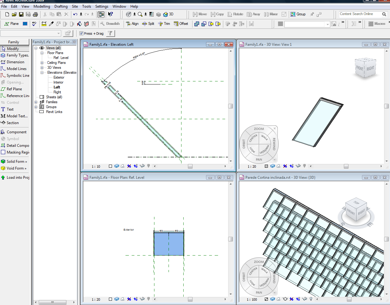

Hey folks, I've been working on building some vertical-lifting glazed panels in Revit, but so far I'm a bit stumped.  I've attached an example from Turner Exhibits.  I modeled some in Rhino, but I'd like to set up a parametric model so I can open and close them.  I'm using Revit 2010.  Anyone with ideas, please drop me a line.
Thanks in advance.

Create a "Curtain Wall Panel" family and use the "REF. LINE" (not Ref Plane) to create that "ANGLE" parameter... also you must create the "Mullions" at the same time in that family....
