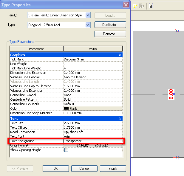

Is there any way to remove that annoying white rectangle behind dimensions in revit, so that i only have text?

Edit the dimension and change the Text Background -->Opaque to Transparent
