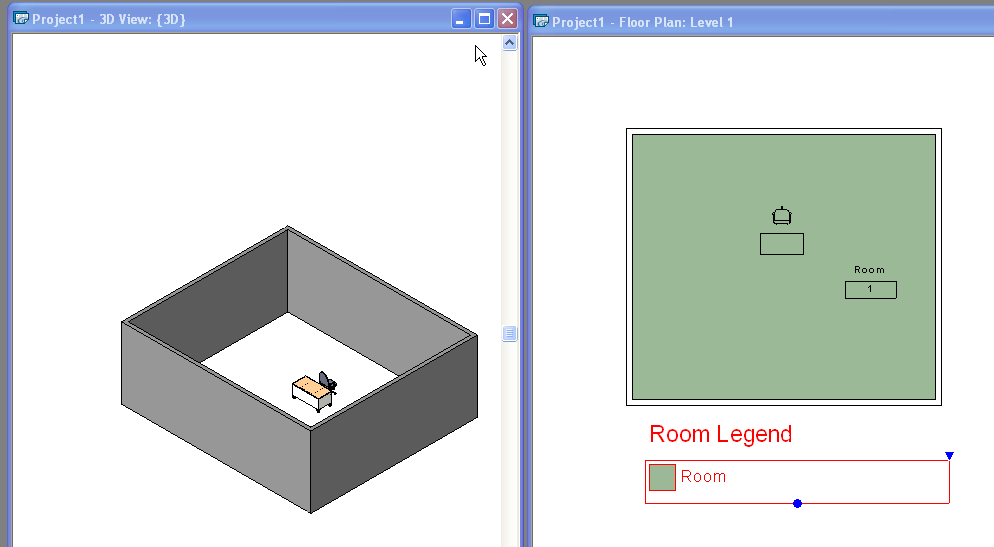

Fri, Jul 17, 2009 at 7:29:45 AM | Filled furniture
Sorry but it did work in 2008 as seen in the attached image.  At the time the question was asked, I was using 2008.  It appears not to work in 2009.  I have not checked it out in 2010.
