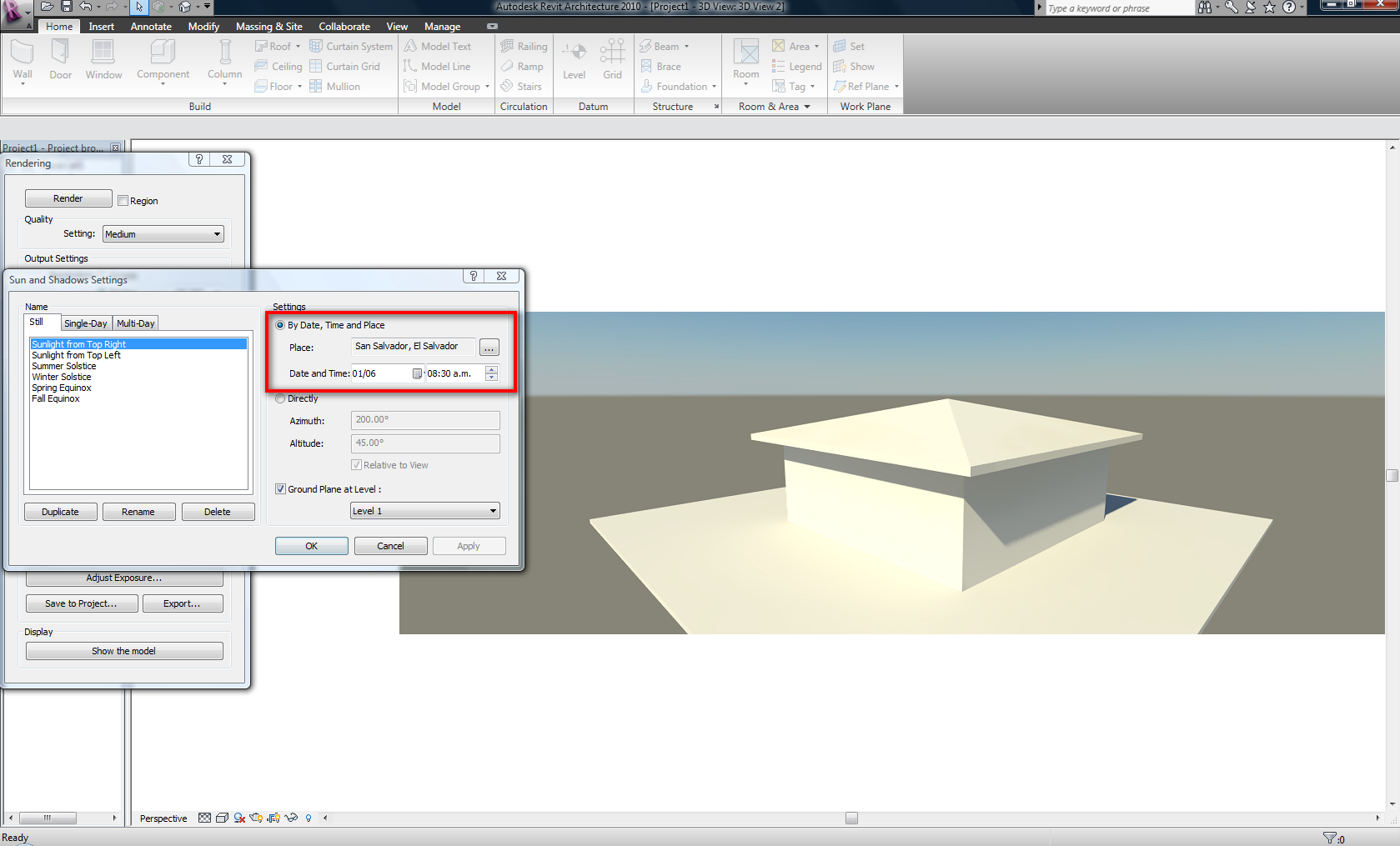

i wanted to ask: is there a way to make different shadows in the prospects of the same Revit file? I have a building and I put the shadows on June 2nd, but on 2 prospects they look great, while the other two prospects are completely black, with shadow. can I do something to make those 2 black prospects look nice, with shadows on December, for example, and the other two prospects with the shadows on June ?

In what view?? plan, elevation, section, perspective, what??? Duplicate the view....

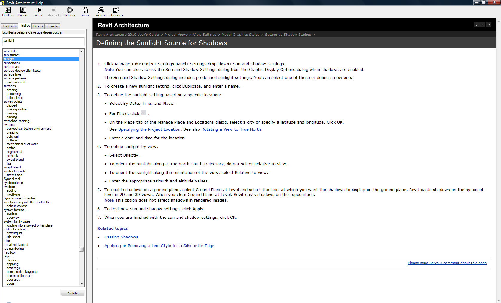

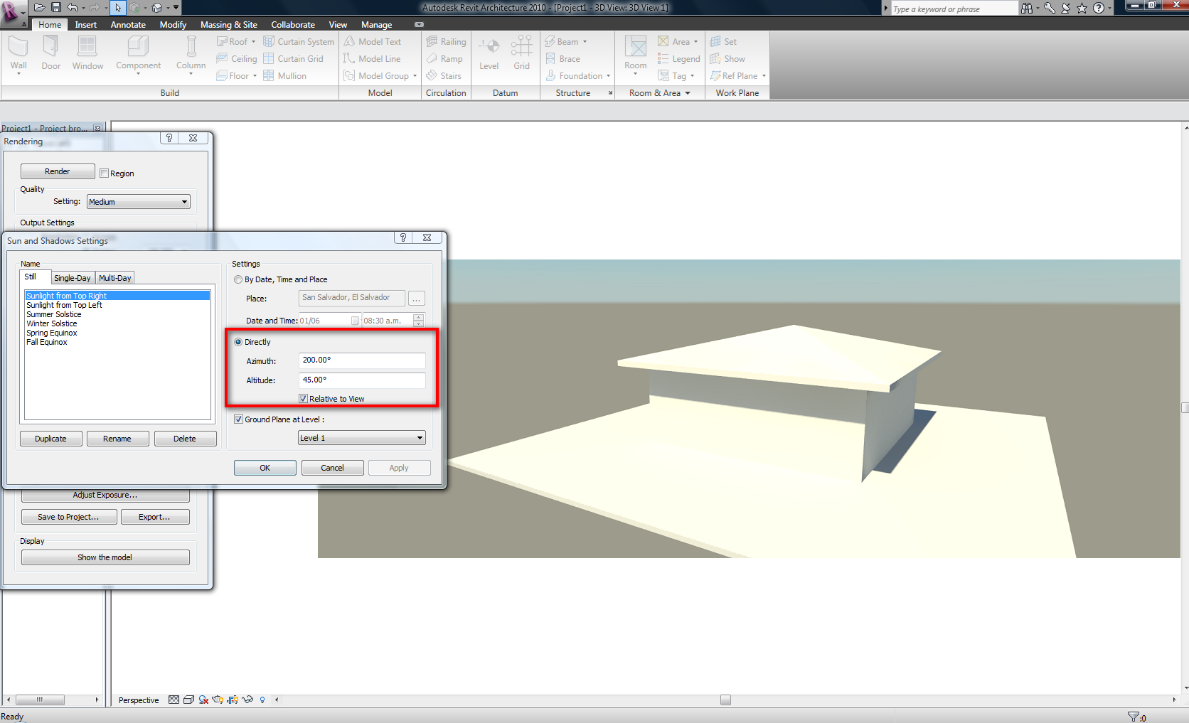

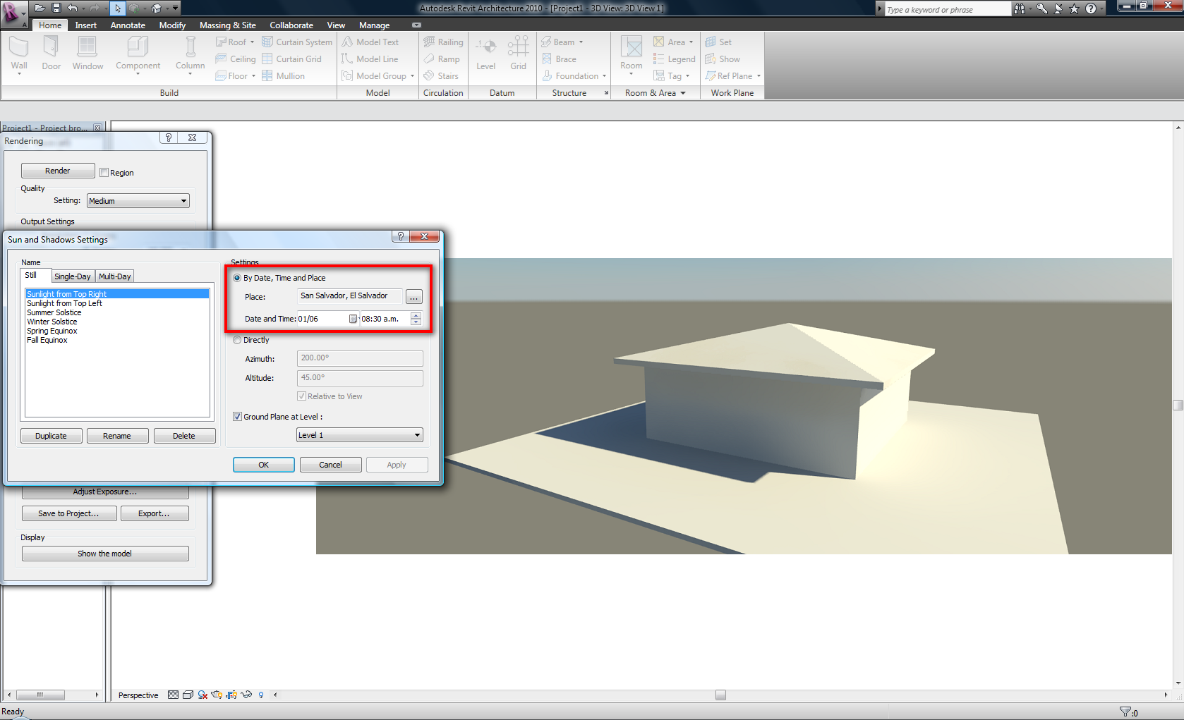

Hi hoopes, as you can see in the first image (north view), set in the same month like yours (June), the sun illuminates almost all that façade, but the south façade (with the same settings) is almost dark by the shadows. But you can "manipulate" the sun position by changing its azimuth and/or altitude (see the same south façade in the third image). You should read the help menu to learn more about it.
