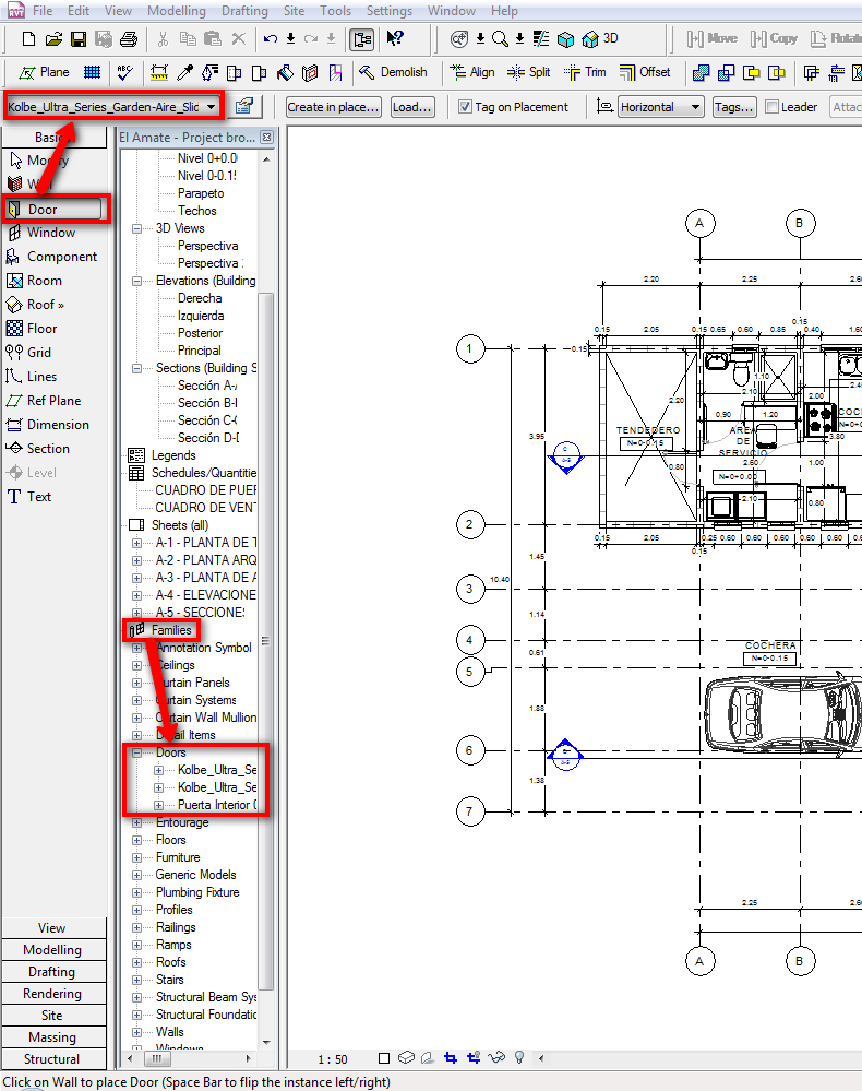

Hi jprado, you can verify if your doors are loaded in the Project Browser-->Families category, if so, just drag and drop to your mode (see image).

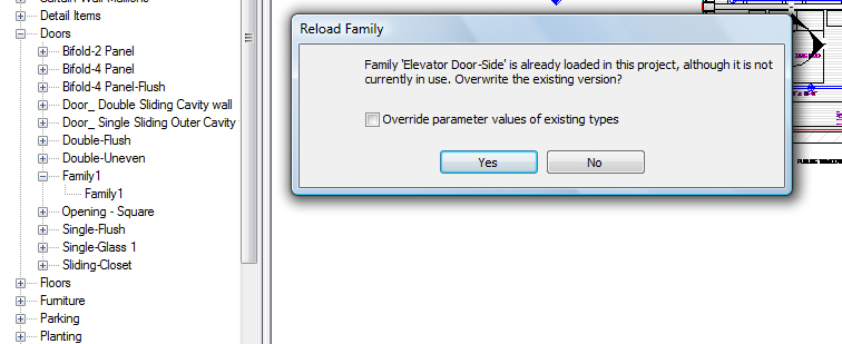

thanks, but revit says the family is loaded but not in use, even though it does not appear in type selector or project browser.  see image

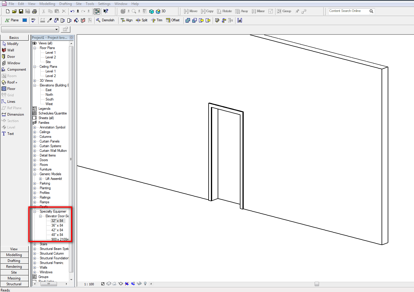

Hi jprado, I downloaded the same elevator door you have just to try, you can find it in the Project Browser-->Families-->Specialty Equipment, just drag and drop....

Thanks eland73, that makes a lot of sense.
Families loaded, but not visible.
