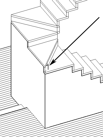

we have an exposed edge winder stair, enclosed from below by a wall.  the problem i can't solve is how to create a partial miter at the corner so that the wall from below does not come through the riser of the corner winder.  Any thoughts? (i'm a newbie and apologize in advance for the confusing description!)

Images of the issue????

of course, see below.

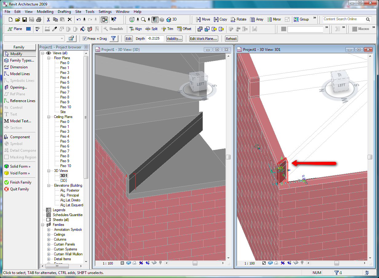

Create a VOID in-place in the category "Walls", then use the cut geometry to cut that portion of wall...

unsuccessful.  create-in will not let me create a void without something to cut.  could you be a little more step by step?

Can you wait??? I'm upload a video for you...

See the video: http://www.megaupload.com/?d=3RR7Y3UV

Perfect!  Great video.  Muchisimas gracias!
