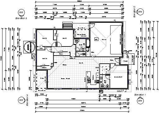

hi all i have just relocated to a new company and they always copy and fax plans through the copier (gives me the shits) but everytime they do that it makes the roof lines really light and hard to see. i have my roof as a underlay so the lines always come up grey. is there a way to change the roof lines to come up dashed .25mm black lines besides using the linework tool?

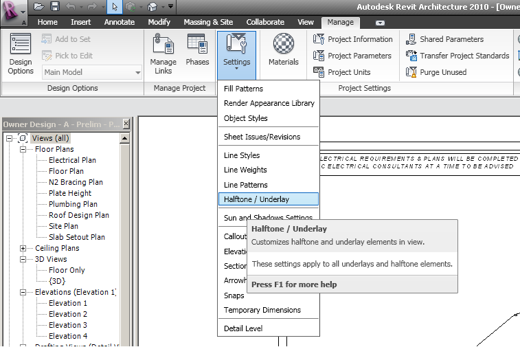

its alright i found how to change it automatically so happy Smile feel free to ask if you have the same problem

once selected "underlay / halftone" (in attachment) selected your weight and pattern and untick the box if you choose not to apply to halftoned components.......
