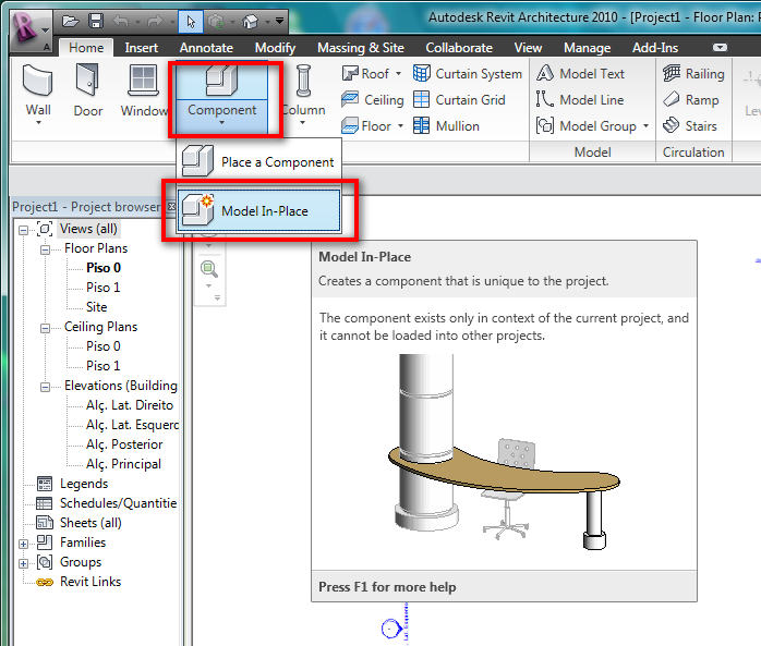

massing and site > in place mass
Thu, Apr 30, 2009 at 2:26:16 PM | 2010 sweep editing
Joined: Tue, May 22, 2007
5921 Posts
4 Stars: 205 Votes
The OLD create in-place is in "HOME-COMPONENT-MODEL IN-PLACE", here you can draw by "Solid Extrusion, blen, sweep....., the "massing and site > in place mass" is the OLD "MASSING"....

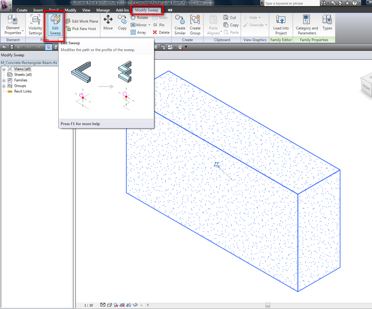

What if the sweep was created in an RFA file?
I can't find the same menu options when editing the family.
I'm attempting to modify an existing concrete t-beam.

RFA file is a "Family", RVT file is a "Project", when you "Edit" the family and you pick in the object you have option to edit and change what you want....

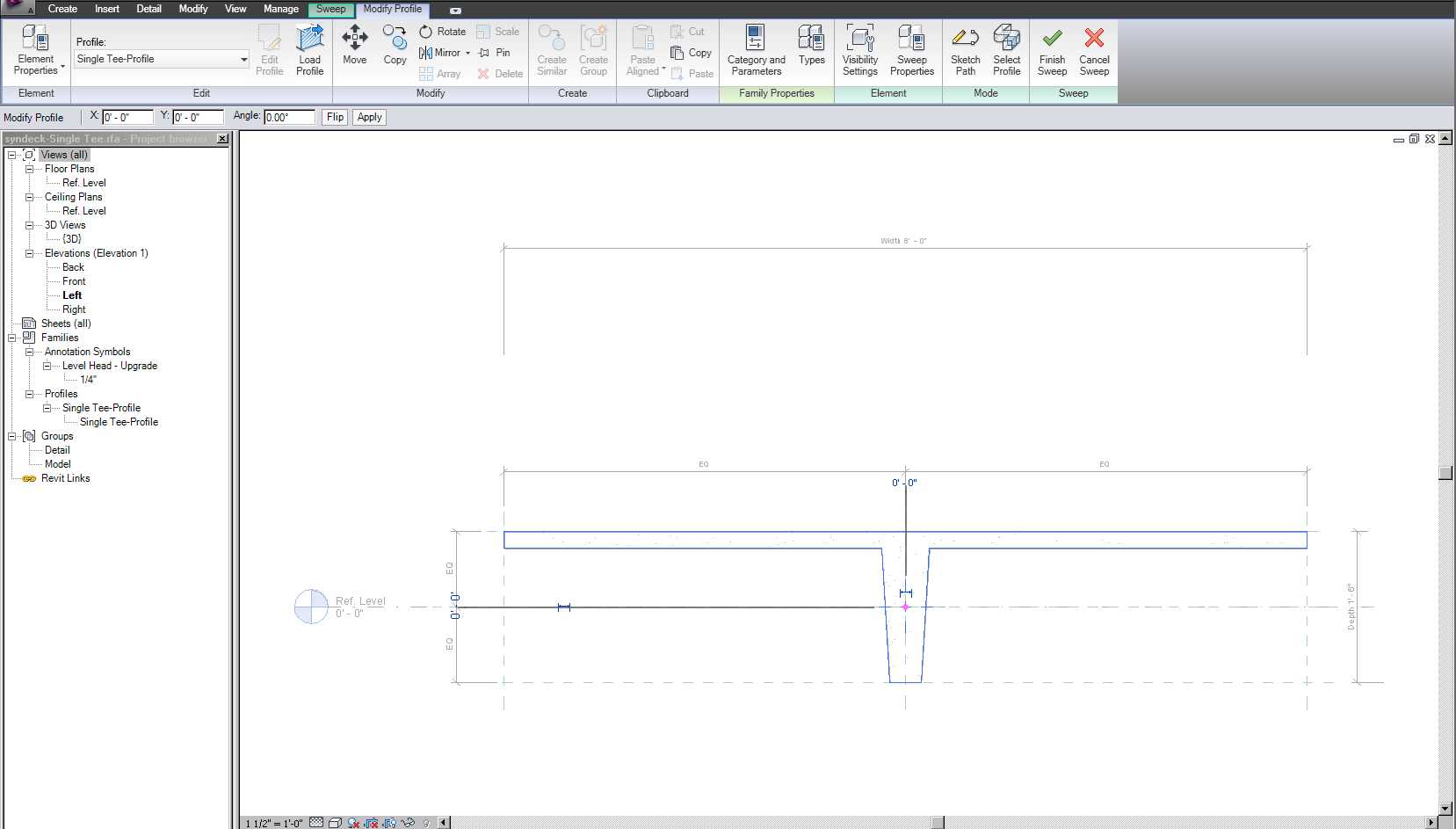

I'm attempting to modify an existing concrete t-beam and I can't edit the "patern"

The "pattern"??
follow the arrows...

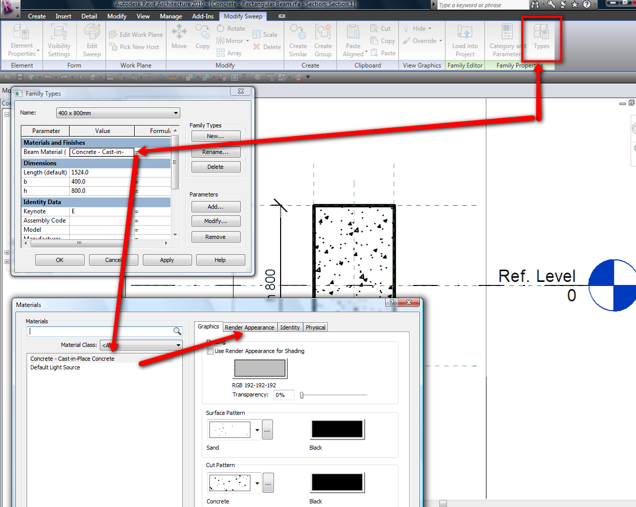

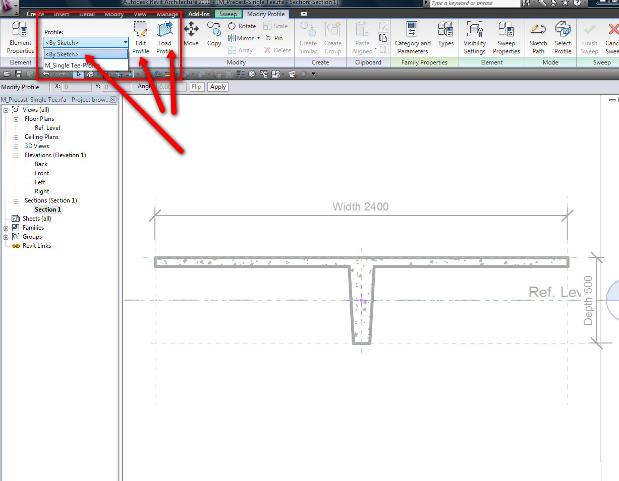

My terminology my be off a little.
maybe this picture will help.

You can Load a Profile already created in a "Profile Family" (because that's the case you have in this family) OR you can change to "by Sketch" and draw the new profile you want to that Croncrete T-Beam....

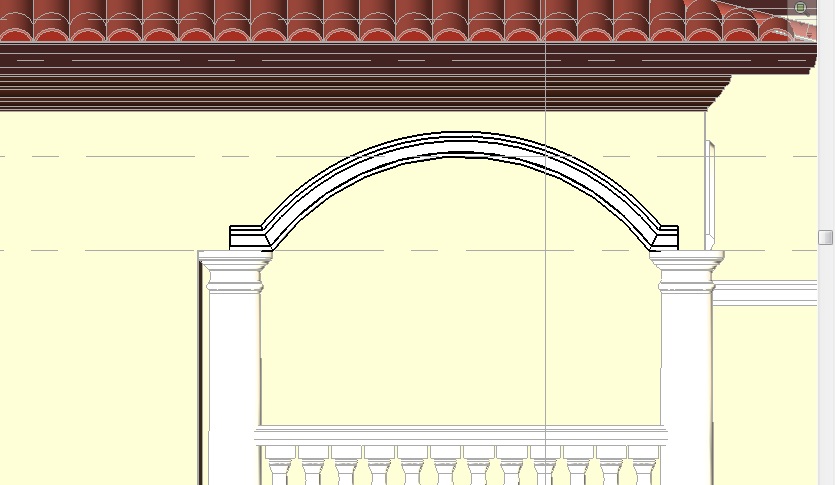

I created a sweep on the arch but I need to return it to 90d at the corner and at the end too.
Please help!
