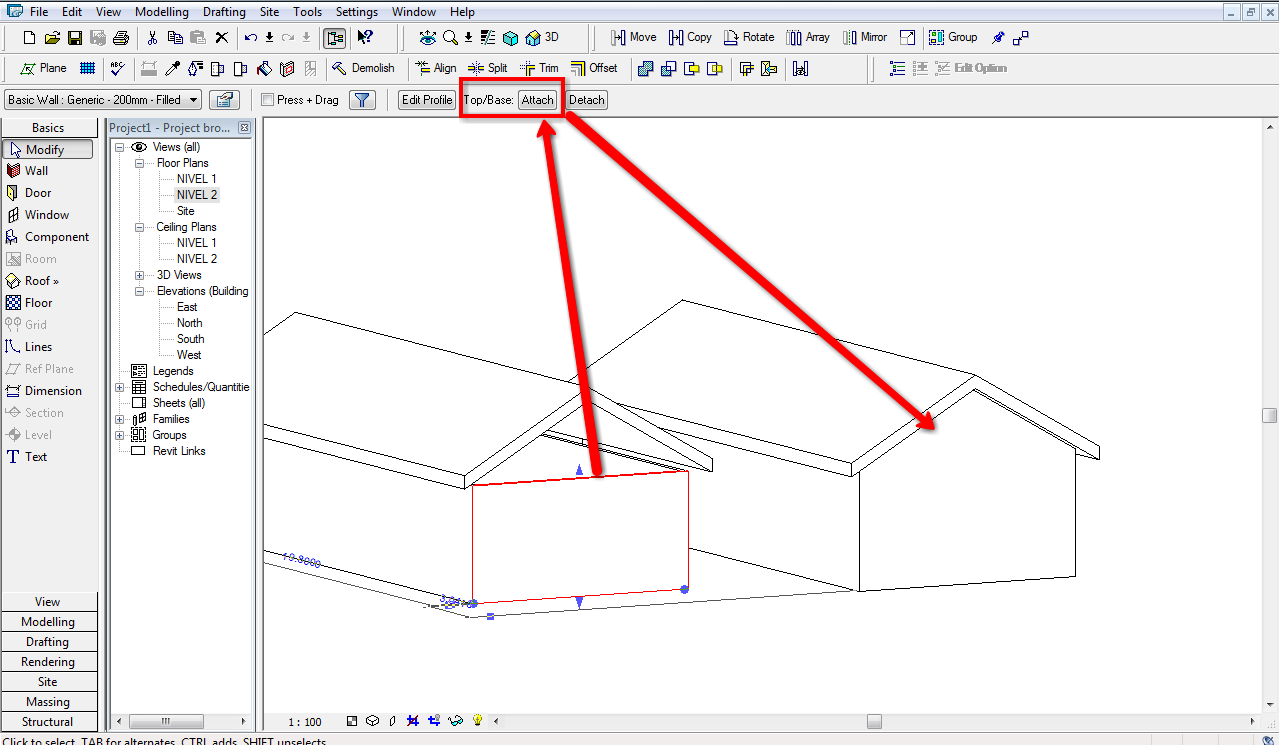

Alright, Here is the deal as simple as I can make it.
Basically I have a rectangular building... I want to make a slanted roof. from the east to west, or west to east... whatever. It doesn't matter. So basically a box with a wedge on top of it. When I make the roof, it just puts a slanted roof with no support on the sides or the end... If you need a visual... The box (the building) and just the top of the the wedge sitting on top of the box. ever more explanation... basically a slanted roof with no support from the sides...
Do i have to make a slanted wall? how do I fill in the sides.. Do I make a mass? grrr.... Doing an archive project for class... getting frustrated. TY for any help!

Attach the walls to the roof...

Hi zwcm98, pick the wall, then pick "Attach" and pick the roof (see image)...

I tried and here is what it says.... Sad
Can’t create Curtain Wall Mullion. The portion of the curtain grid it was placed on no longer exists.
and 2nd error... One or more references of the highlighted element have become invalid.

First, you don't said it's a "Curtain Wall", second where is the building??? thirth what version of revit are you using???
