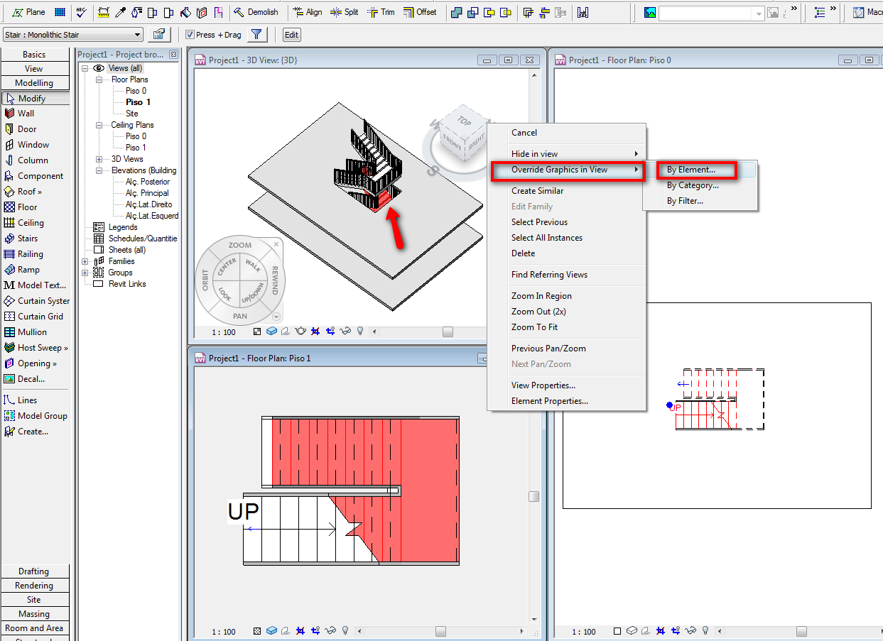

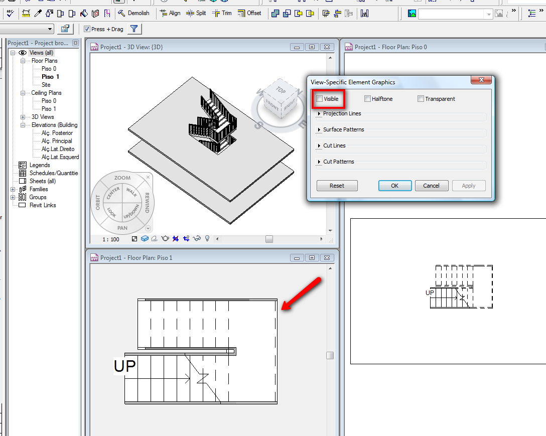

Did you try in that plan view going to the "Override Graphics in view>by Element and turn off the "Visible"??? if this is what you want....

That works, but then I don't see the down. I'd like to be able to see both the up and down as I should be able to.
