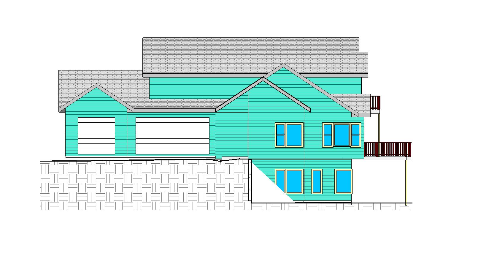

It looks like the topography "behind" my elevation shows up as a blank. What controls the level that my elevation symbol shows up in plan view. This particular elevation only shows up on the basement floor plan and not on the site, first floor, etc.

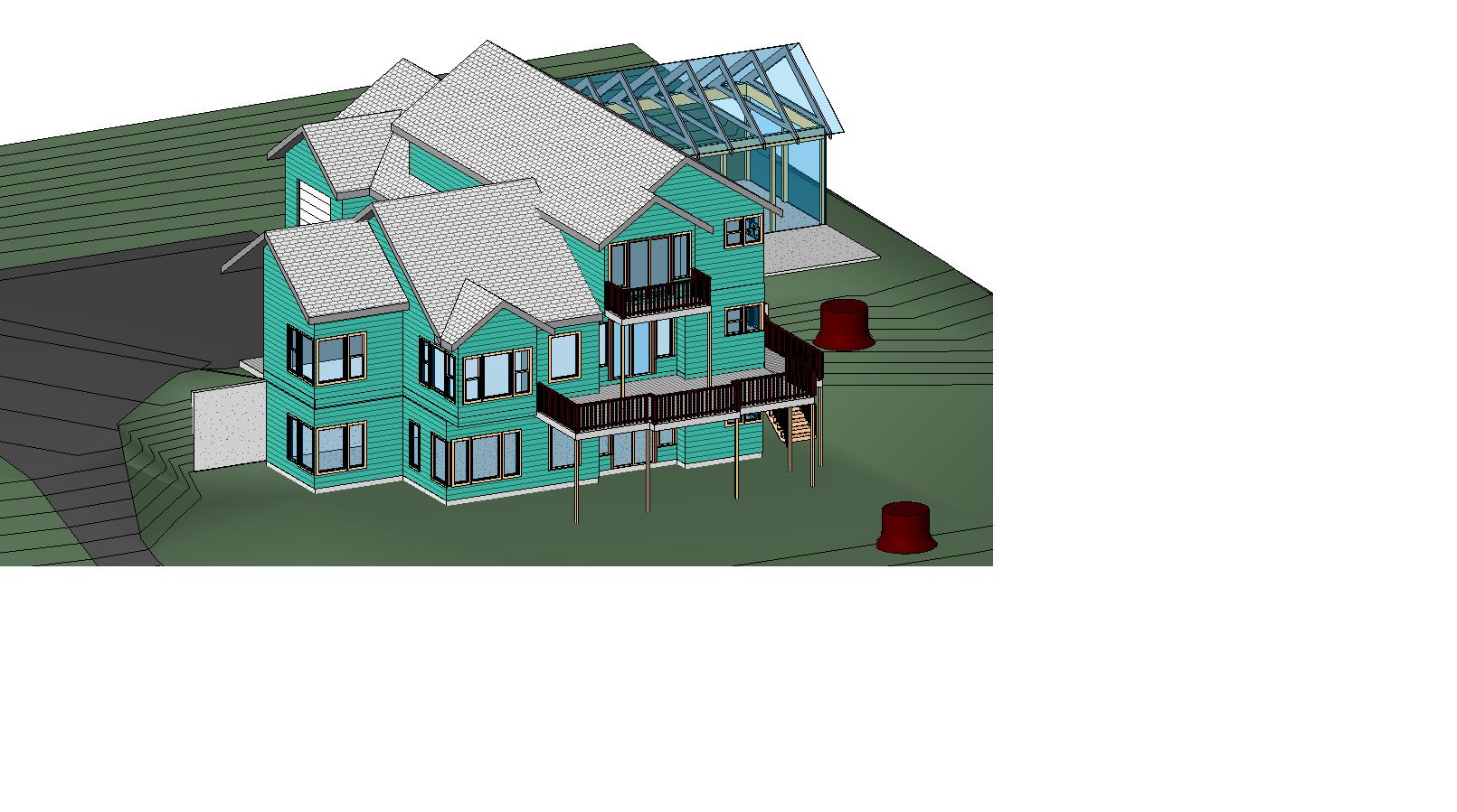

Here is a 3D view of the house.
Tue, Apr 28, 2009 at 2:14:42 PM | topography in elevation shows up "blank" space. any work around?
Joined: Tue, May 22, 2007
5921 Posts
4 Stars: 205 Votes
In that view, move your elevation symbol near to the house....
i think your elevation is cutting that portion of site (topo)....

I tried to move the elevation. Thats why all I can figure is the the elevation looks "backwords" a little ways for some reason.

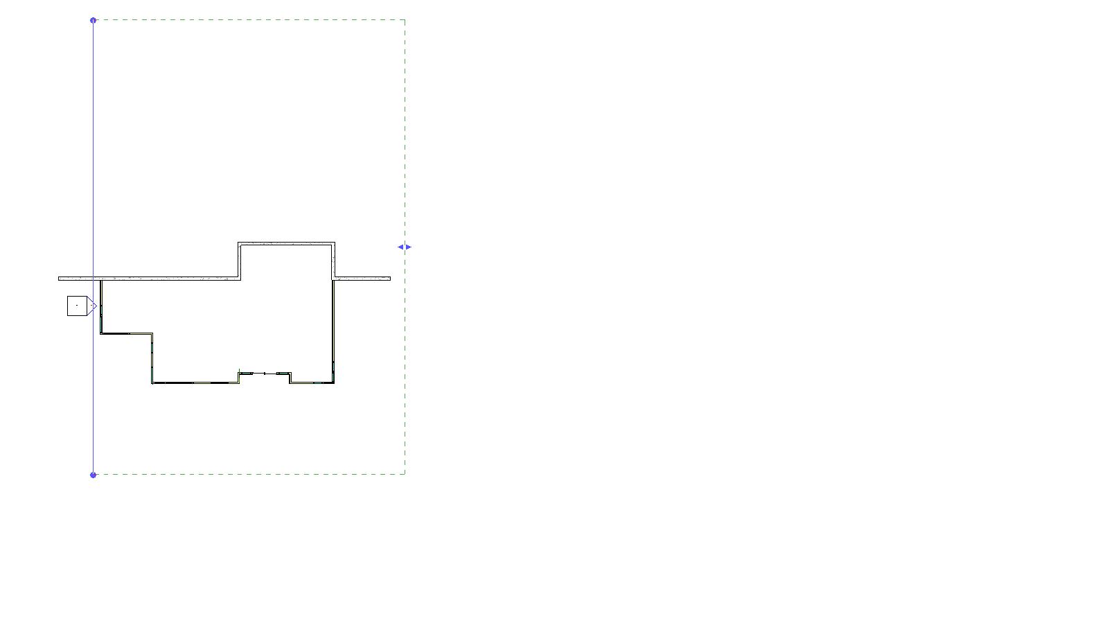

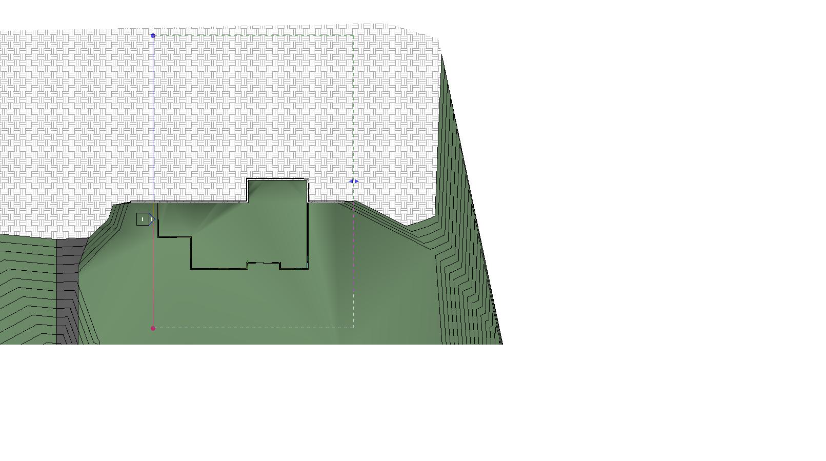

Maybe this screen shot is a little better.
