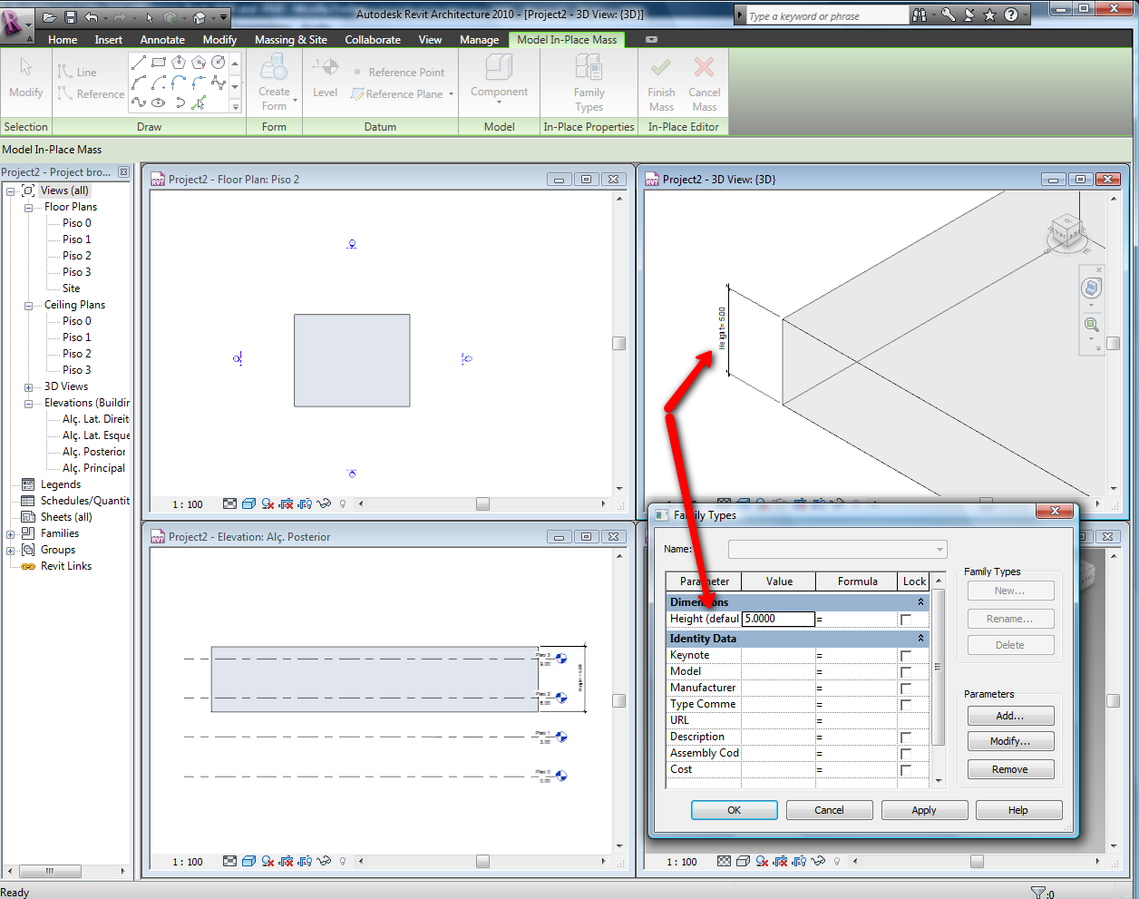

Are you talking to Create a mass in "Massing" (conceptual mass) or Create In-Place (solid extrusions, sweep, revolve...)??? You can also create a dimension and put a parameter to your height value or change the height with the Temporary dimension like you can see in the image attached...

If it's as simple as putting a dimension onto a mass, and typing it in from there then that could work.

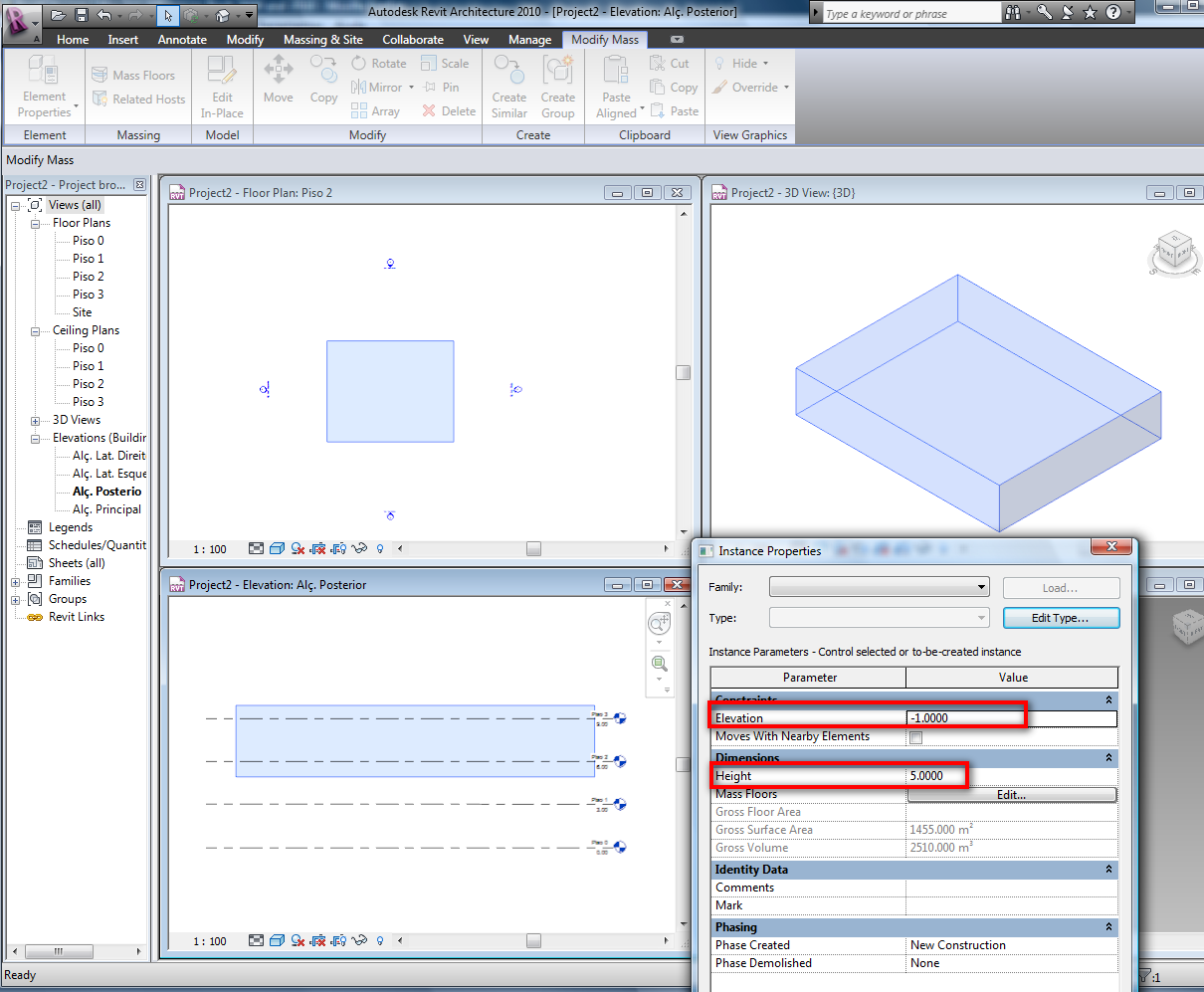

What I was meaning in the outset is if you have say, 10 levels of 3000mm each (Sorry I'm in NZ!), and you create a mass of 2000x2000,2000 in a say level 3 (6000mm up), but in fact, want that mass to sit 1300 down from level 3. In 2009, I would higlight the mass and use the offsets to say 'Begin at -1300 - Finish at 700'.
 Is this achieveable in 2010?

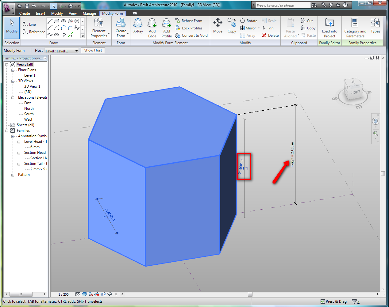

By default you have in the element properties of your mass the "Elevation", it's like an "Offset" to the base (positive value=UP, negative=DOWN) and you can create a parameter to the height like you can see in the images attached.... and YES there are two ways to create masses, "Create in-place" and the OLD "Massing"....

Awesome, that is extremely helpful. Thank you.

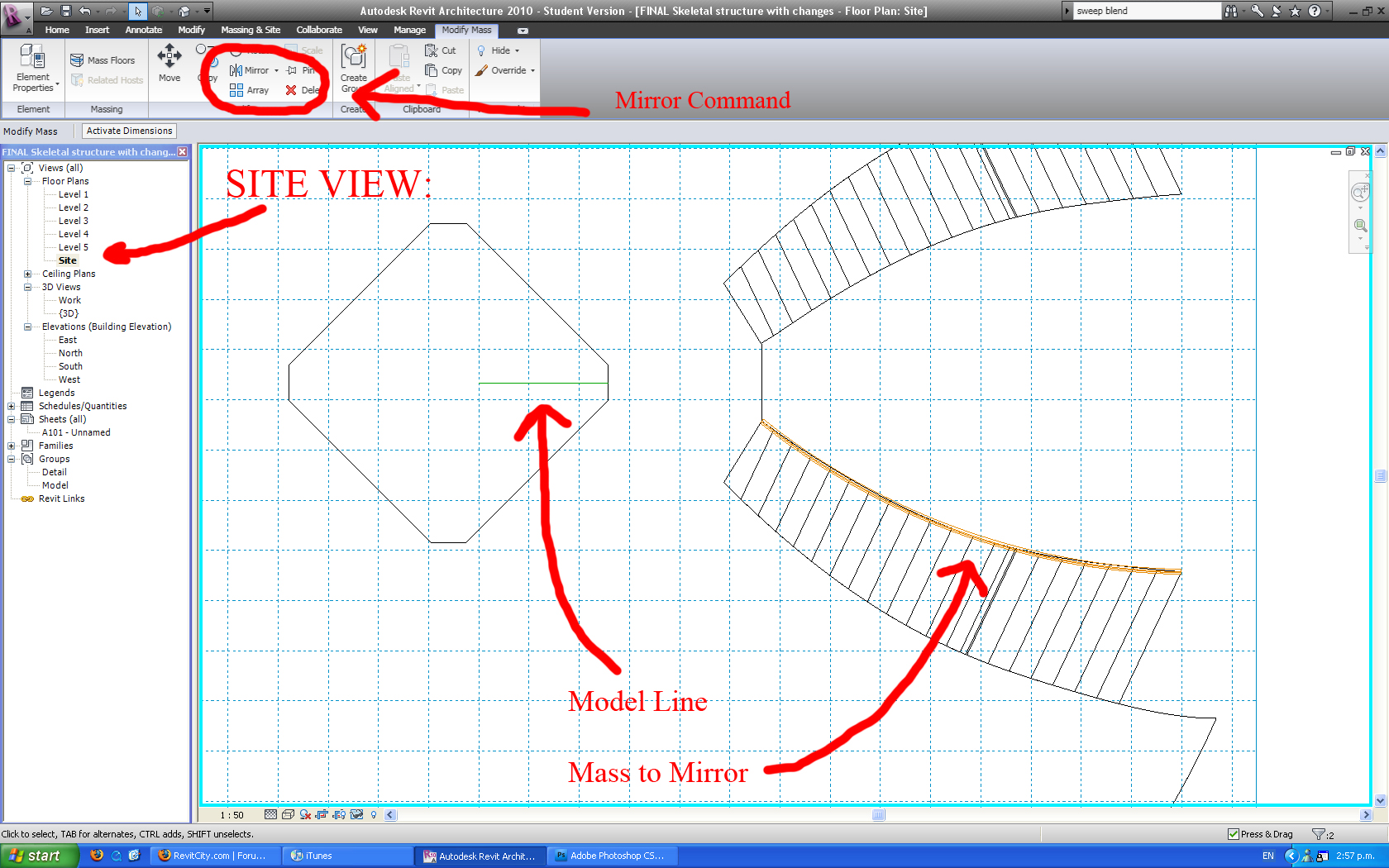

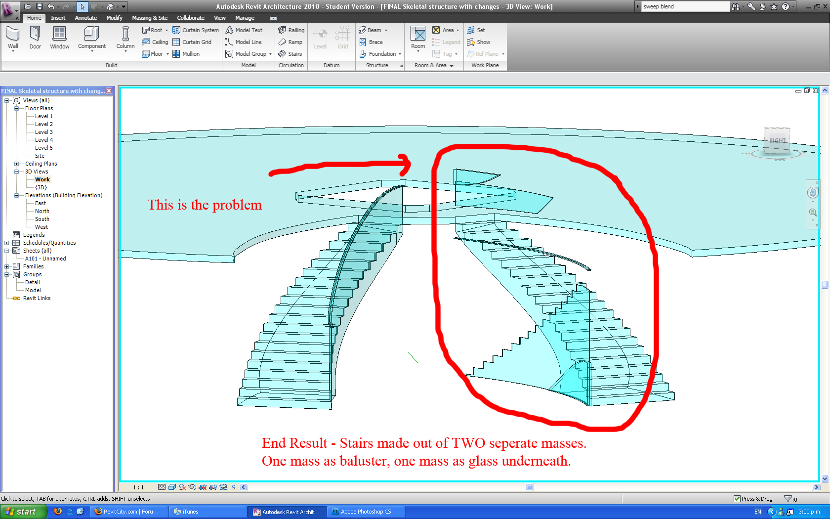

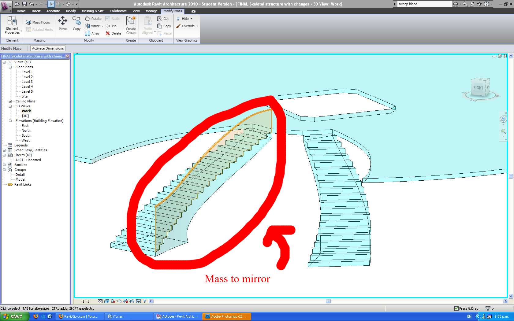

Ok, I now have an issue with the 'mirror' command.
First of all, I made a component in masses (In this case, a baluster for my stairs), and simply wanted to mirror it onto my other mirrored stairs via the 'Site' view, select, a model line along the mirror axis and the 'mirorr command' under the 'Modify Mass' ribbon.
In 2009, I had no such issue. At some point messing around in 2010, I must have switched an option, because it was working for a while - and no gives me the following. Image one shows the mass, image two the process of mirroring, image three the end result.
 Attached is a screenshot of the final image also for understanding.
57896_revitcity_1.jpg57896_revitcity_2.jpg57896_revitycity_3.jpg57896_revitycity_4.jpg
