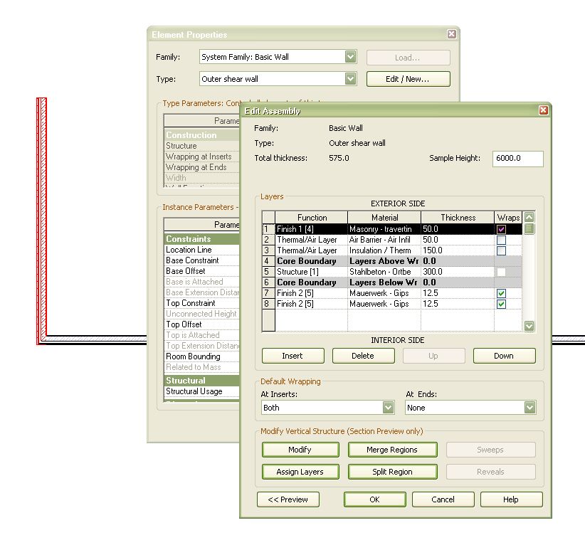

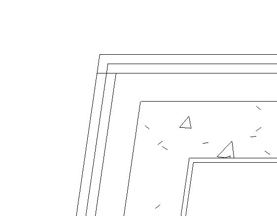

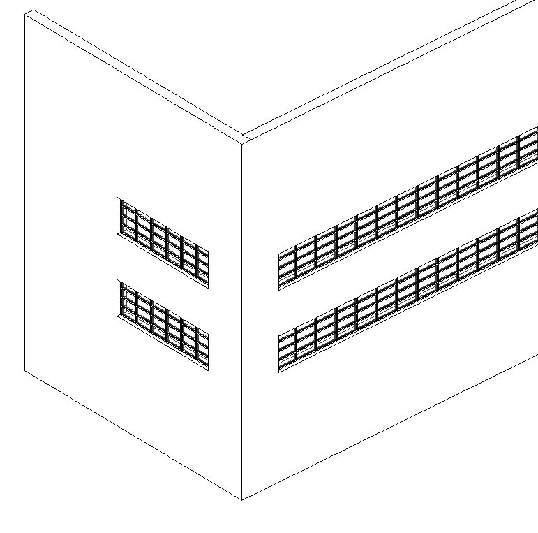

When two walls are NOT drawns at the same time (even though their location line is the same), they connect quite nice in plan (PLAN), but there usually appears an unnecessary line in 3d view (3D). I can only get rid of this line by "edit wall joins/mitter", but it doesnt seem a noble way (cause plan view changes this time)
When I draw those same walls at the same sequence, there is no problem.
Is there a way to avoid this, or cure this (other than wall joins)?

This never happens to me no matter how I place my walls.  Can we see a screenshot of your wall settings?

I send the screenshot and the rvt file as well

Strutural use of the wall, is as shear.... , if you change it, it will appear correct...
If that is realy the use you want to give to wall, them you should use the wall join tool, and set it to mitter....

Thank you Cercas!
One thing is strange though; free from the component of wall, when the "structural usage" is changed to anything (other than "non-bearing"Winking it fixes the situation. I wonder is it a bug or something? Cause I cant understand the mentality behind?
