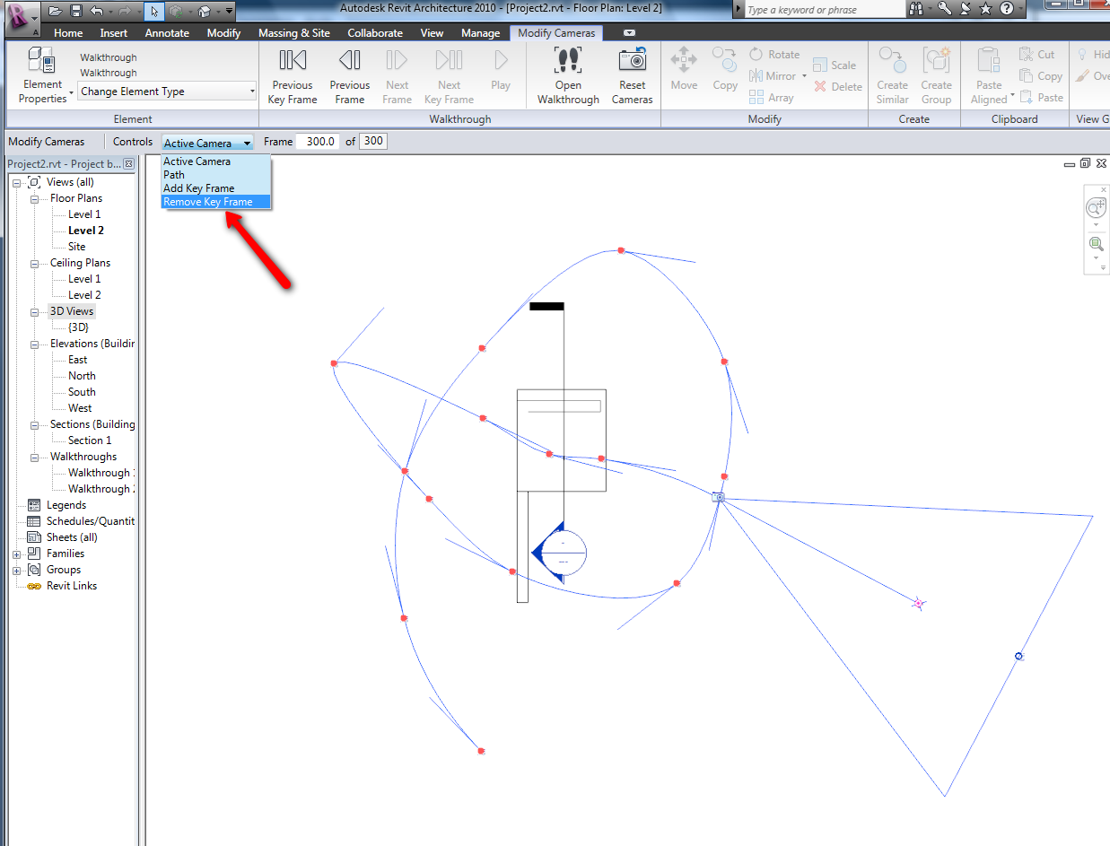

When i export the walkthrough and play it in media player shows the frames running on the upper left corner.
 is there a way or an option in revit  where i can choose to show or not the frames in the video when is playing?
 thanks in advance
Thu, Apr 23, 2009 at 1:15:08 PM | Walkthrough
Joined: Tue, May 22, 2007
5921 Posts
4 Stars: 205 Votes
No, you must use external software to do that.... I don't know yet in 2010....
 Ok, tested, in 2010 you can remove the frames in the video before export the walkthrough, just pick in the path, edit, go to the controls and select "Remove key frame", GREAT...
