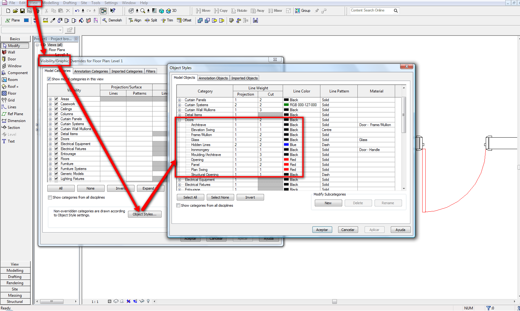

hi, when you place a door into revit it apears red in plan view...? how can you change that red line to black so everything in the plan view is all black. Cheers

Hi One Thing, did you try: View -->Visibility/Graphics -->Object Styles -->Doors??

Ooooh, no i didnt. Cheers
