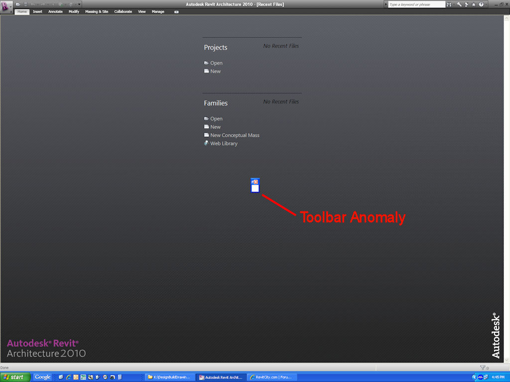

Just wondering if anybody else has had this problem since installing Revit 2010.
- When first opened, there is a small toolbar in the middle of the screen (see Screenshot 1).  It looks like the old AutoCAD toolbars, and like a new one created before buttons are dragged to it.

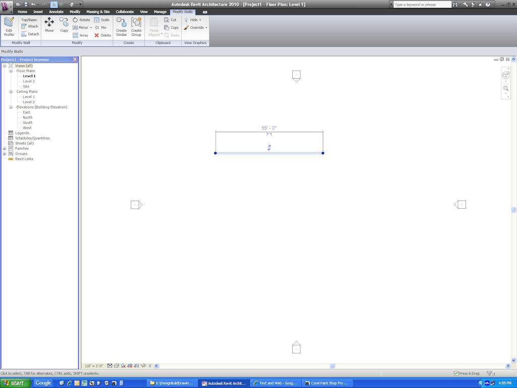

- When the toolbar is left alone, the ribbon menu works fine.  Note the "Element" panel of the ribbon is displayed (see Screenshot 2).

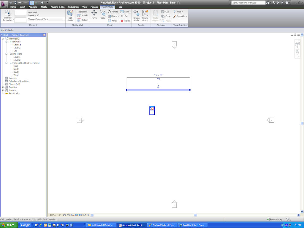

- When the toolbar is closed (clicking the red X), the "Element" panel of the ribbon is no longer available (see Screenshot 3).  This is the case for all elements.
Any explanations and/or solutions would be much appreciated.  Thank you

hmmm my only other advise would be to uninstall and reinstall or send a support request through the subscription center and provide them with a journal file for 2010

Actually a support request was submitted to Autodesk and their reply was that some display managers for certain video cards such as nVidia and ATI, have been known to cause this problem.  In my case, disabling the nView Desktop Manager cleared the problem up.
Just wanted to give a heads up to anyone who may have the same problem.
