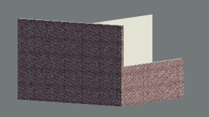

I need to cut out some of the wall on the front elevation of a house I want to design but I am not sure how to do this. I want the wall to kind of step up in height over a garage from the end of the building.
Just don't know how to cut the pattern out.
All help appreciated and an image if it helps of the wall I want to cut the pattern in.

Click on the wall in plan or elevation and choose "edit profile" from your options bar.

I've learned how to do that now
Thank you
