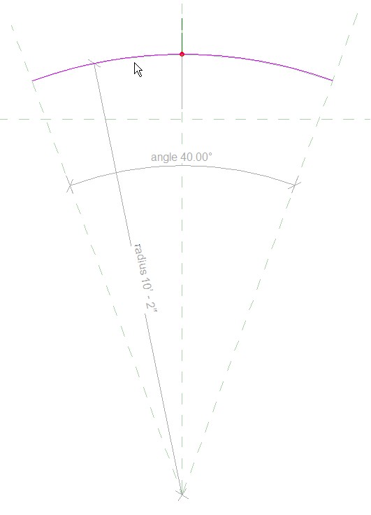

Here is a simple mockup where angle and radius are instance parameters (labels)

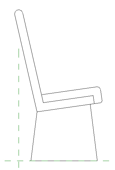

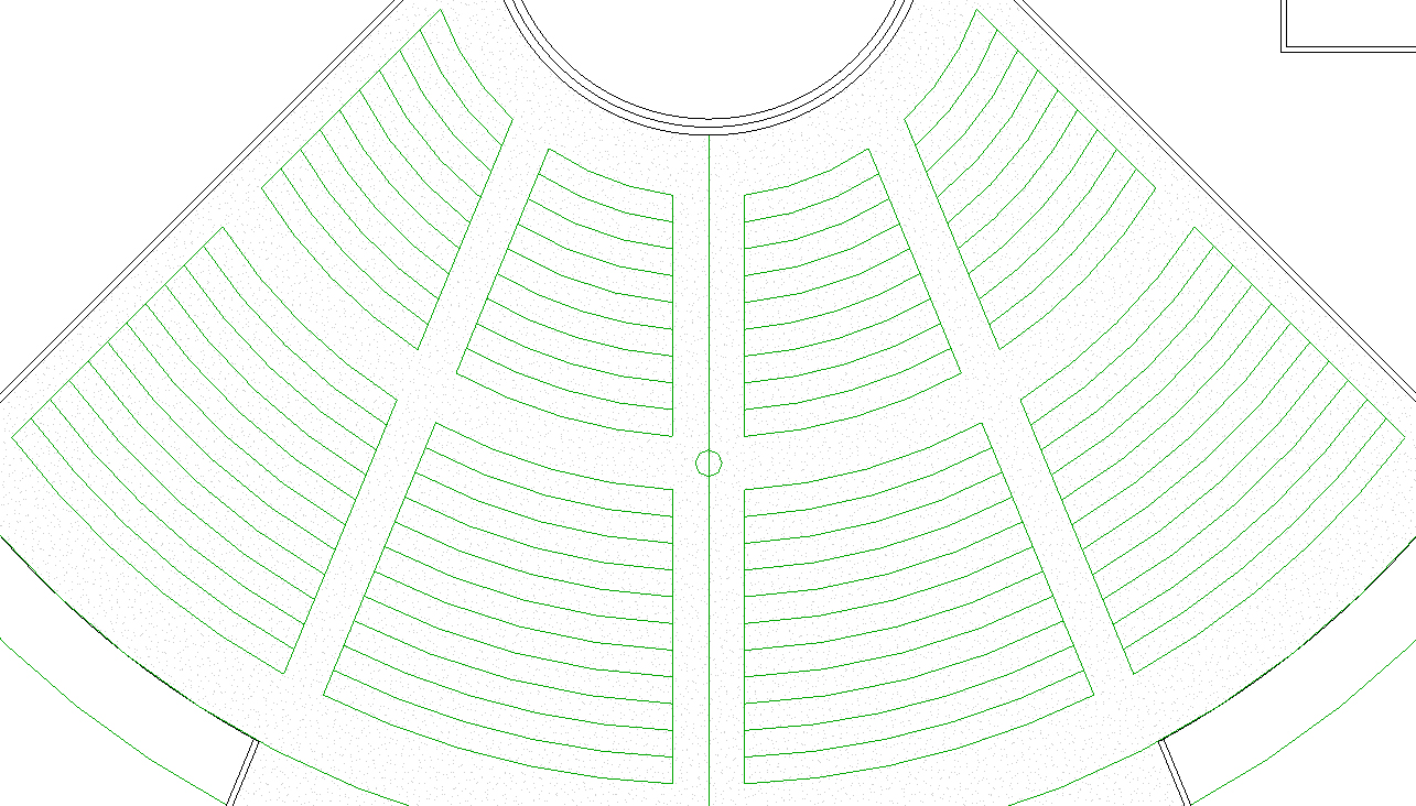

I set the pew body up as a profile family, so now do a create a new mass and do a solid sweep with the profile I made? I always have problems with sweeps so if you know a really detailed tutorial that shows how to make sweeps I would appreciate it. I attached a profile of my pew and a plan of of how the pews will be laid out. Thanks for all the help

Look at my previous post.  The right image is the sweep layout within a family.  You can use a generic, non-hosted family or a floor hosted family ... a furniture family ... any of those templates to create the family.  If you look at that image, I have two parameters (they are lables for dimensions within the family.)  One is the angle, the other is a radius.
I started out by laying out my tow angled reference planes as equal angles from the center reference.  Then I dimensioned this angle and referenced it to an instance based label I called angle.
I then added a referce arc with the center at the intersection of the three planes and extending from one angle to the other.  I added a reference radius dimension then changed that to an instance based label called radius.
Now I created a sweep extrusion.  I described the path by pointing to the referce arc line ... path done!  No need to dimension or lock anything.
I then switched to the profile, opened up a side elevation and drew a profile much like yours.  Done with profile, done with extrusion, saved profile with a name and loaded it into my project.

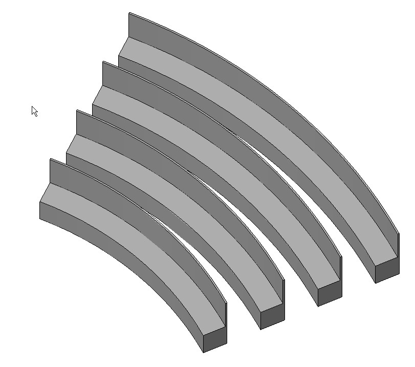

I placed an instance of this pew setting the angle and radius.  I suggest you pick a middle one... reason comes later.  Pick it and copy in place (hit a 0 when prompted for new location).  Now click on the pew that you see (they latest will be picked).  Change its' properties to a new radius - old radius + pew spacing.
Now you have two pews with same center point.   Pick both pews and copy in same place.  Change outer one to last radius + spacing.  Change the inner one to originalradius - spacing.
Now you have 4.  Copy outer 2 and do it again.
