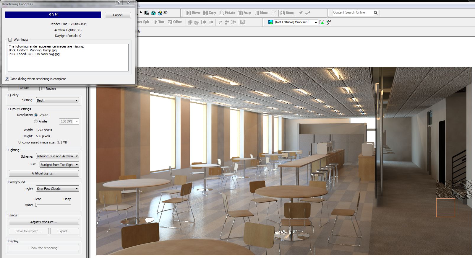

Ok, I've ran  quite a few renderings in Revit and never has it taken over 7 days to complete!
Take a look at the screen shot.  Why did it take so long?  It's at 72 DPI.  Also I have Revit 64 Bit, Vista 64, 4 GB of RAM??  It's a fast computer?  Any ideas why this happened?

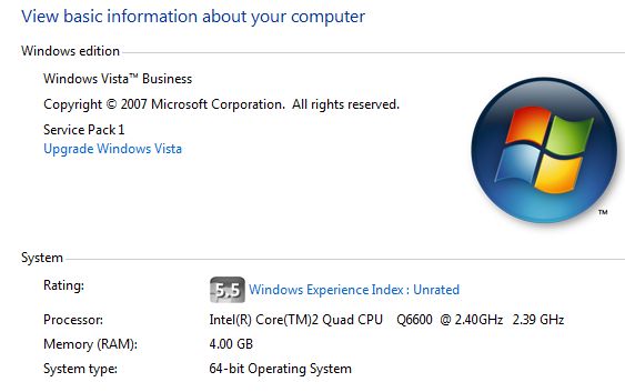

Please provide more detailed specs of your computer, this appears to me to be a hardware issue. You have the correct OS and Revit 64 but your machine specs may not be qualified for this 64 bit combo.

3.5 Stars: 7 Votes
What specific specs are you looking for?
I attached a shot of my system for you.

well that is a good processor for rendering, might I suggest upgrading to at minimum 8 gb of ram (go 24 if you have the cash)
 You have a decent amount of glossy materials and alot of interior and exterior light combination. I dont think any of that is enough to make that render take nearly that long. Have you tried any other machines to see if you have the same issue?

With Vista 64bit you can run unlimited memory I believe, I once worked on a machine that could hold 128 gigs. There are limitations to motherboards though, you would have to find out the maximum the motherboard can handle.
 My suggestion if you render a lot is to consider Max Design, I use it and am able to render a scene like that on a similar slighty better workstation in about 20 minutes. It takes a little time to learn but should be extremely beneficial in the long run.

Look at you ceiling texture....  that would account for a lot of your problem as well as all those reflective surfaces.

If you don't render a ton I wouldnt bother with Max at all, its a pretty pricey program and Revit+Photoshop can usually do the trick. But yeah like WWHub said, the glossy reflections slow things down as well as using daylight portals. If I render in Revit I tend to stay away from artificial and sunlight interior renders. I have had some pretty good luck in the past with just artificial light if memory serves correctly.

There could be a few other factors in your slow rendering.  If you have a lot of lights in your model try createing light groups and turn off all the lights that are not in your rendering.  Also, you can use the section crop to crop out most of your model except for what is in your rendering.  I use both methods and it speeds my rendering time up significantly.
