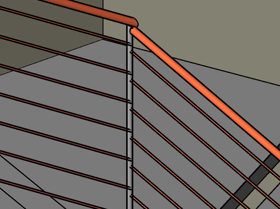

Can I  change a material of the baluster placement, a vertical support of the railing? I had change the material of the horizontal rail but I don’t  change a vertical.

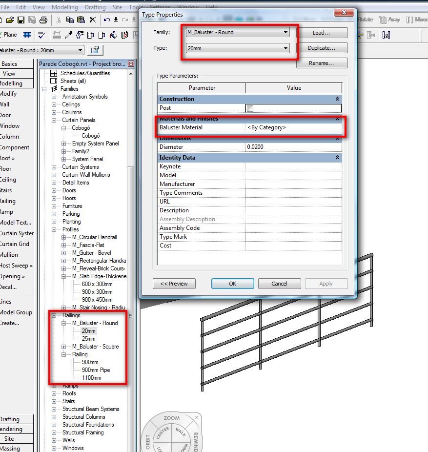

Simple...

Thank you, yes is very simple but  I don’t know this, option for change properties of objects.
