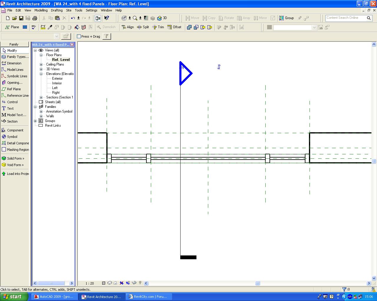

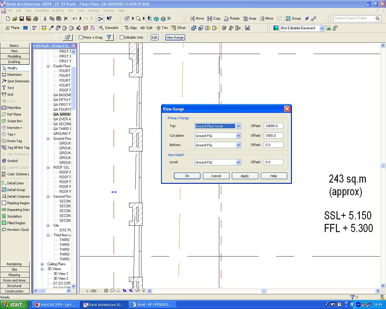

Hi all,        please have look at my window, in family in plan view its looking ok, but when i load into project the cutting plan is always on top (i need to cut it below the arch in plan view) though i changed cut plane in view range its not changing. Could any one help me to solve this issue? i attached images of window plan view in project plan and family.

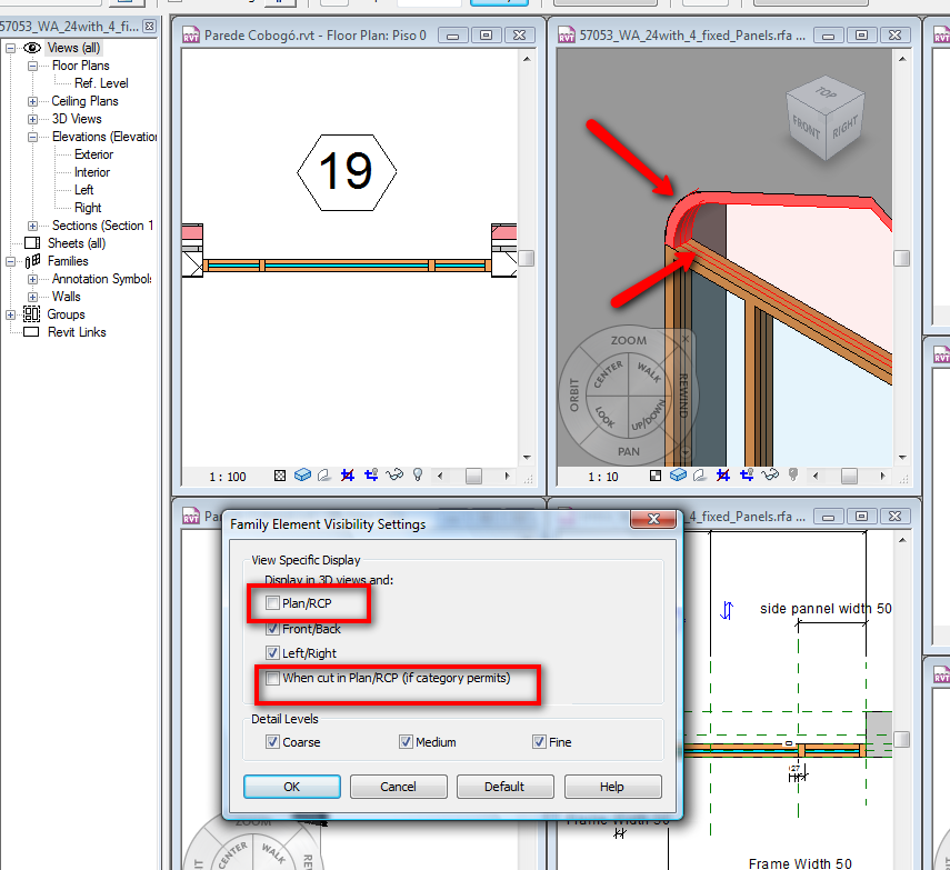

Like you can see in the image, put off those elements in the family (glass and frame in the top)....

thank you typhoon its working fine now.............
