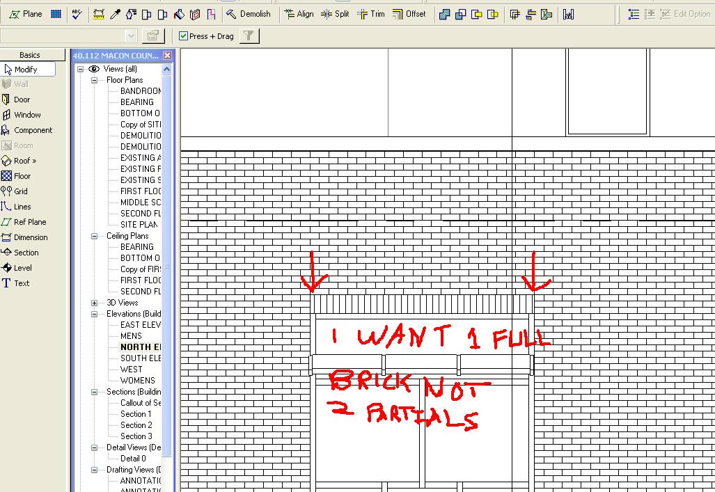

I am having a problem with splitting a face and applying a pattern to it.  I cannot adjust the position of the pattern.  I want to show a soldier course that has all complete bricks not two that are cut like in the attachment.  Is it possible to adjust it like you can do with a dropped ceiling pattern?

Are you using a model pattern - if so, you can adjust it.

Did you use the "Align" tool???
