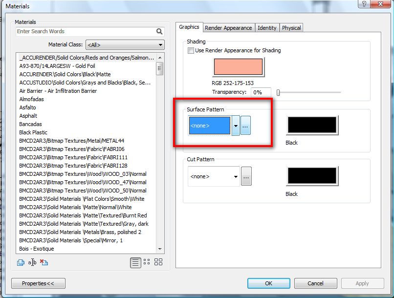

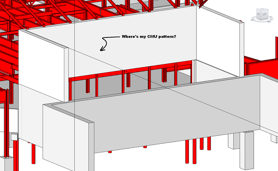

I think the attached picture says it all, but when in 3D view no surface patterns are displaying. They display fine in section and the cut pattern shows fine in plan, but nothing in 3D.
Our firm is fairly new to Revit so we don't know what we're doing wrong and searching endless documents and websites resulted no solution.
 Any help?
We have the surface material set as a model pattern and not drafting.

Are you sure you put in the "Surface Pattern" a pattern???? MODEL PATTERN..

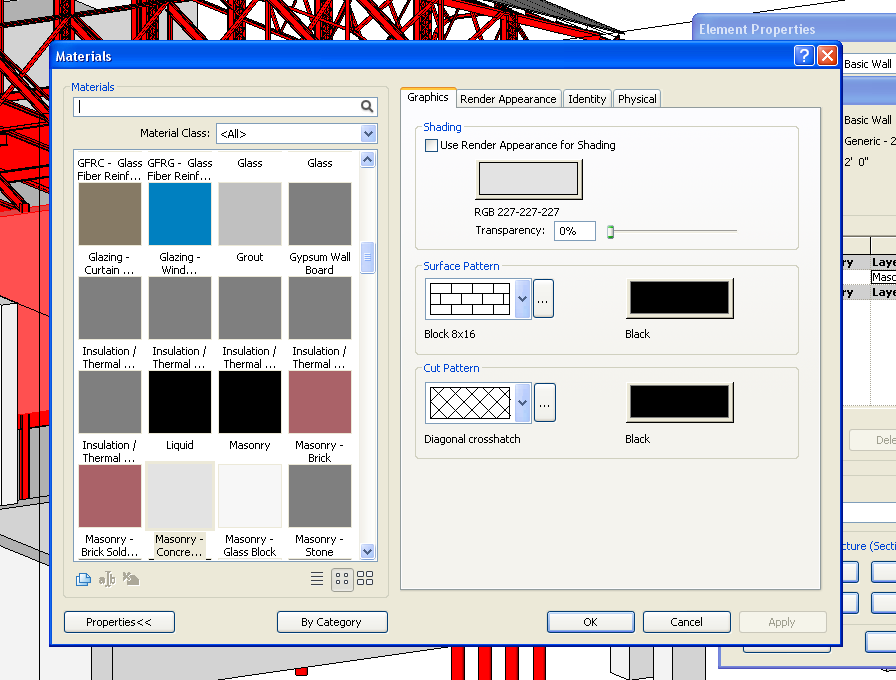

Fri, Apr 10, 2009 at 11:09:56 AM | Typhoon
dlewy
Joined: Tue, Mar 10, 2009
20 Posts
Quoting Typhoon from 2009-04-10 10:51:04
" Are you sure you put in the "Surface Pattern" a pattern???? MODEL PATTERN.."
This is what I have it set as (See attached)

We can not tell from the screen shot if the pattern you are using is a drafting or a model pattern.    If you want the pattern to show up in all non-rendered views, it must be a model pattern.  Otherwise it will only show in elevations and you will not be able to adjust it.

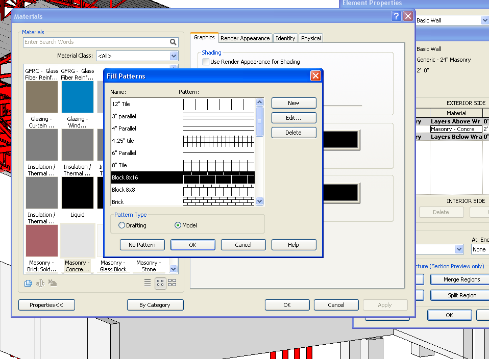

Is the wall backwards? ( drawn in the wrong direction) Check to see if the other side has the pattern. But if the wall just has one material check to see if Surface pattern is a "model" or "drafting" pattern. If its model try creating another wall to see it that works.
Fri, Apr 10, 2009 at 11:40:41 AM | Missing surface patterns in 3D
dlewy
20 Posts
Here's a screenshot showing that model is indeed checked.
 The wall is not backwards and the pattern isn't showing up on any sides. Also tried drawing a new one and got the same problem.
