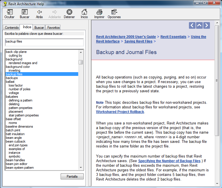

I Keep getting extra files for example....
I save my project as "House" and eventually i will get House.0001, House.0002, House.0003 its annoying to me.... please fill me in on how to turn this option off!!!
Fri, Apr 10, 2009 at 8:19:24 AM | Revit extra files... How do you turn them off?
jarosa
jarosa Avatar
Joined: Mon, Feb 18, 2008
251 Posts
4 Stars: 5 Votes
Those are your backup files. You can change the number of backup files to 1 if you save as, options.
Fri, Apr 10, 2009 at 8:25:52 AM | Revit extra files... How do you turn them off?
naegelbc
Joined: Tue, Apr 7, 2009
3 Posts
Is this in "Settings" - "Options" ?
Fri, Apr 10, 2009 at 8:26:45 AM | Revit extra files... How do you turn them off?
naegelbc
3 Posts
nvm i found it thank you so much!
Fri, Apr 10, 2009 at 8:27:02 AM | Revit extra files... How do you turn them off?
Joined: Tue, May 22, 2007
5921 Posts
4 Stars: 205 Votes
Yeah, those are backup files from your project, some day you gonna need them....
Fri, Apr 10, 2009 at 9:29:35 AM | Revit extra files... How do you turn them off?
erland73
erland73 Avatar
Joined: Fri, Sep 7, 2007
738 Posts
4.5 Stars: 85 Votes
Yeah naegelbc, you should read this in your Help menu....
