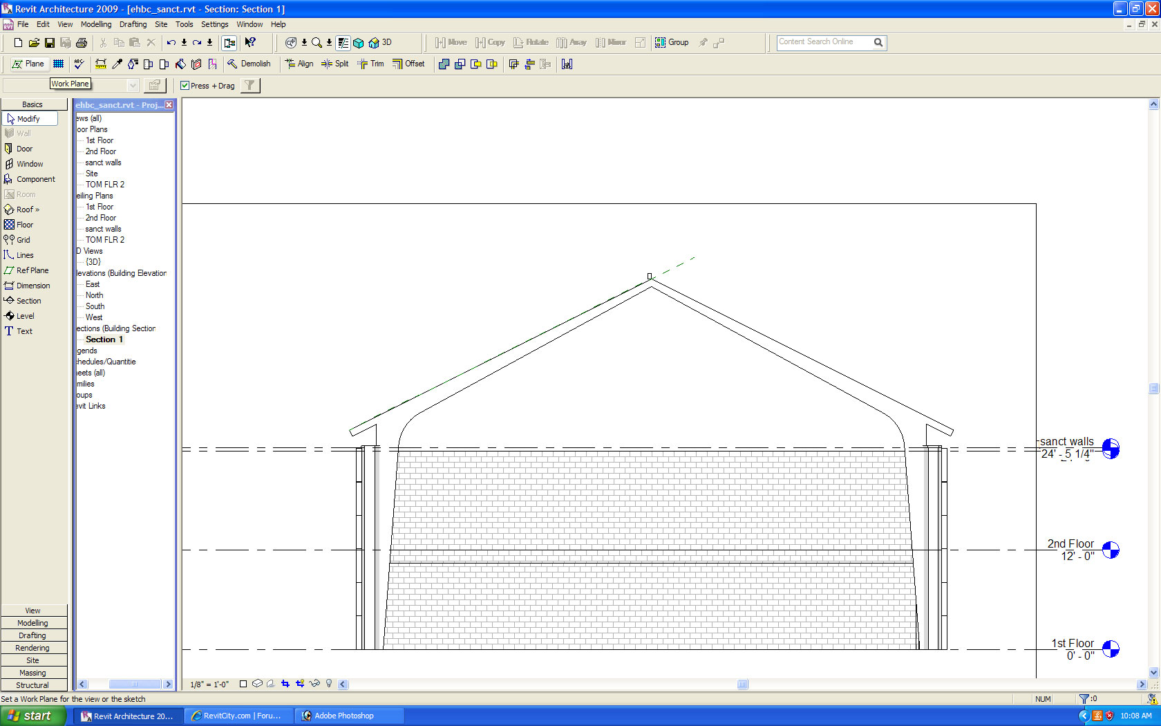

I am working on inputting an existing Sanctuary that was built using wood laminated arches and purlins.  I have successfully got the laminated arches in place, but I am trying to place the wood roof purlins on the slope of the laminated beam.  I created a reference plane that matches the slope, but when I go to rotate the beam it will not allow me to do this.  Does anyone have any suggestions or a better way of doing what I am trying to accomplish?
I have attached files to illustate what I talking about.

See this....
http://www.revitcity.com/forums.php?action=viewthread&thread_id=15734
How do i place purlins in between curved steel beams (for a curved roof)
