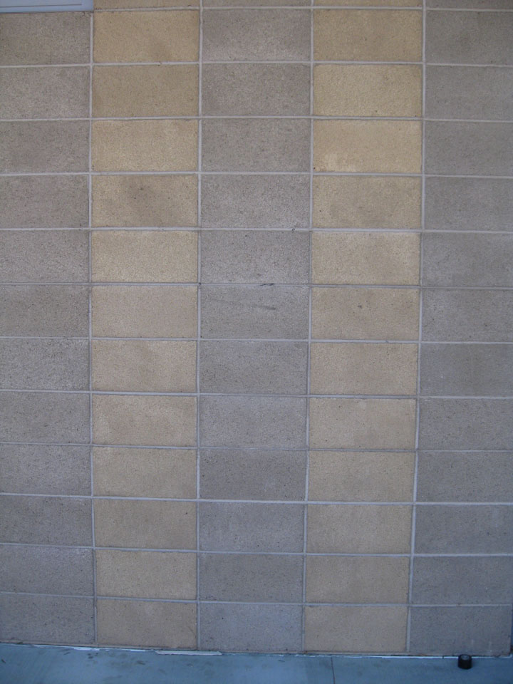

Here are the pics.

Well, why don't you use only a texture like that???? you don't need to split the wall...
