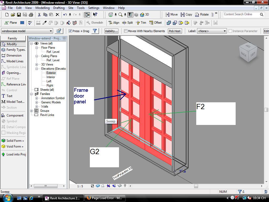

I using Rac 2009 I created 2 generic model family (I call :G1, G2 ) I create Generic model family (I call F2) and loaded G1, G2 in F2 I create Window family (I call F1) and load F2 into F1 I open new project anh load F1 into . I see G1 graphic but i want choise G2 . I must open F1 and change ang load again to project !!!!! . How do change G1 to G2 direct in project ? Help me ! Thanks

Your best option would be to create a Yes/ No visibility parameter. this will allow you to toggle between showing g1 and g2.

Thanks . I sucessed creating this one . Family is interesting !

If I have 3 or more generic model . Their name : A-B-C.....How do change them? . Example their formula : A=empty B=Not (A)AND(C) C= Not(A)and(B) Not working ??????? Thanks

If I understand correctly, try using nested If's.

"If I understand correctly, try using nested If's." I can not do IF (i have not same example) I saw some sample door in forum . But I like to create door family with Frame door panel can change more ! If you have same tut , can you share it to me . Thanks
