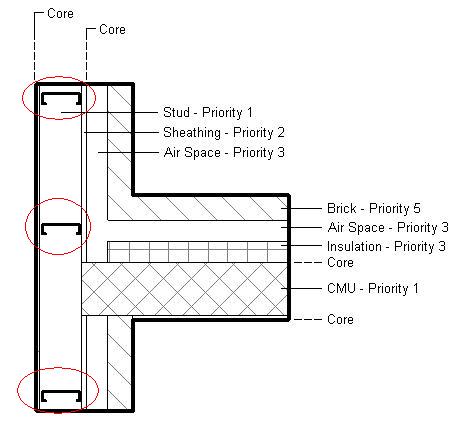

I saw couple of times detail sketch been applied to wall layer.  And i couldn't find any tools to do such a thing.  Am I missing something from my Revit knowlege or I am dreaming?
 Thank you.

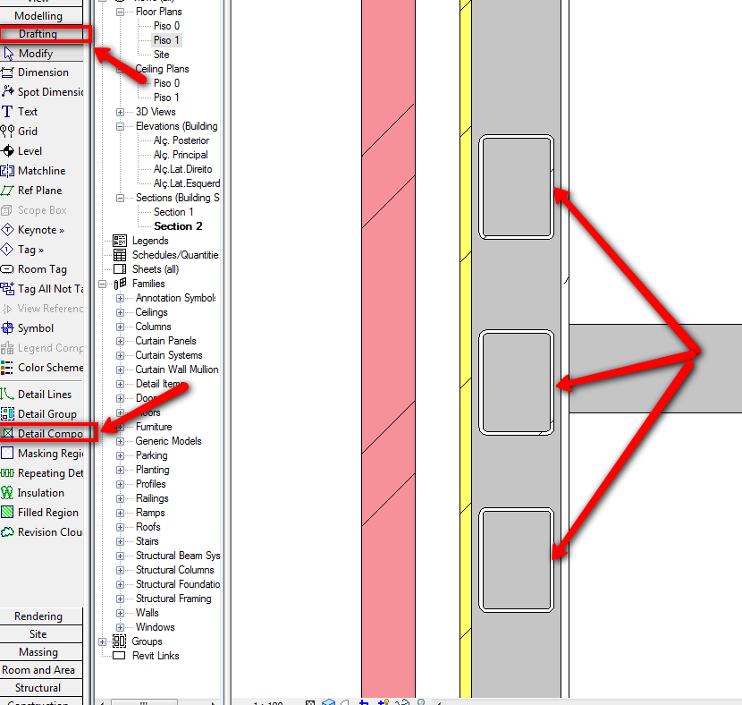

Are you just looking for the Detail components under the drafing tab? Could you be more specific please.

They are called "Detail Components" Smile

Go to "Drafting>Detail Component"

Guys thanks for your tips (I am aware of that), but I was going after if i can sketch something on wall layer so in any section where that wall cut it would show up.  For example anchere bolt, sill plate and head plate...?

That cant be done for a wall, it can only be done in a family, Like casework or furniture you can add a detail so that no matter where its. But as far as adding it to a wall i dont think that its possible.
