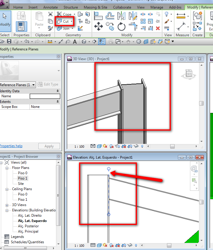

"How do you have revit cut a section at a sloped joist, bearing on a beam, joist girder etc. and have it show a little more accurately in the section."- Create a ref. plane then use the "Cut Geometry" tool to cut the beamto that ref. plane
Wed, Jun 2, 2010 at 3:05:44 PM | Joist Seats on sloped joists
Joined: Tue, May 22, 2007
5921 Posts
4 Stars: 205 Votes
Also use the "Beam Columns Joins" like you can see in the image i attached

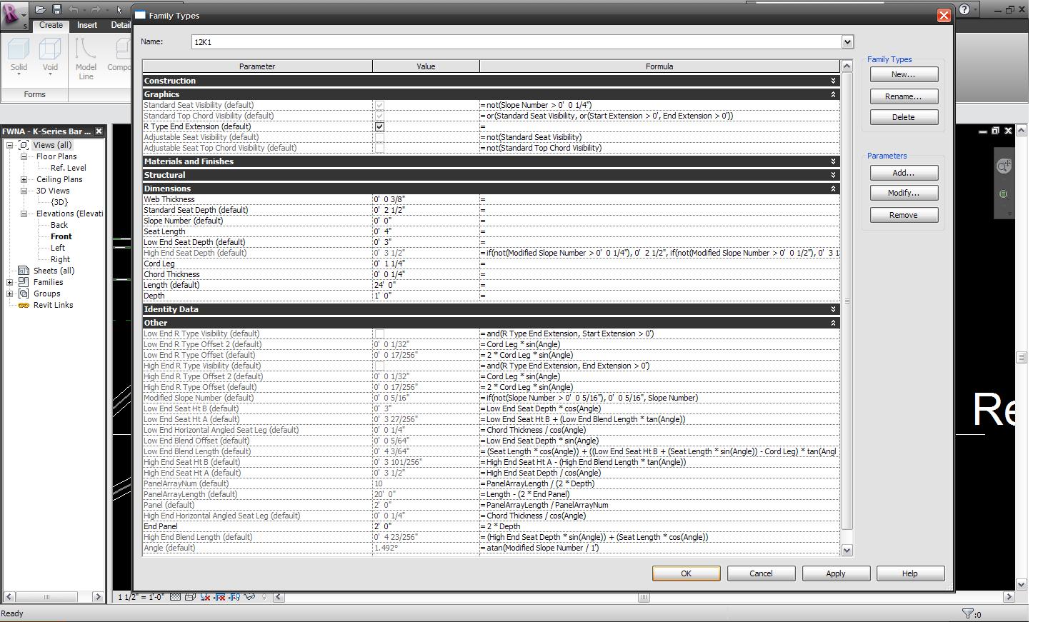

That's not what I meant,  What I want to know is when you have a K series steel joist or joist girder that is at a roof and the joist is sloping, at the bearing seats the seat is manufactured horizontal to the bearing point while the joist is sloped. Right now Revit shows the seat sloping so when you cut the section it's not shown correctly.

You would need to modify the joist family...I haven't done this as it would take a bit of time and if you are not familiar with family creation/modifcation it could take even longer.
 A quick and dirty way I have shown this is in the detail only.  I will draw a masking region to hide the parts of the sloping joist as needed so I can add detail lines for the seat.

Its actually not that difficult to modify the joist family to show the sloped seat. All you have to do is add a blend showing the sloped seats, a couple void extrusions to clean it up, and some formulas to constrain the geometry and visibility.

Do you happen to have the RFA file for this? I am trying to do it manually but keep striking out.
