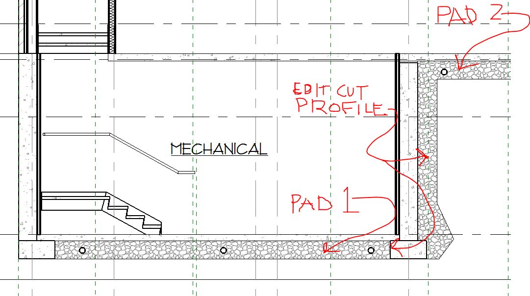

I use the building pad to cut the topo to build my walls.  What I typically do is follow the perimeter of the wall with the pad and I change it to be 12" of crushed stone.  This way, when I cut my section, the stone below the slab is shown.  To clean up any areas of the pad (like extending the gravel around the outside of the wall), I use the edit cut profile tool.

Quoting LIZARD2806 from 2009-03-30 12:21:20
"I use the building pad to cut the topo to build my walls.  What I typically do is follow the perimeter of the wall with the pad and I change it to be 12" of crushed stone.  This way, when I cut my section, the stone below the slab is shown.  To clean up any areas of the pad (like extending the gravel around the outside of the wall), I use the edit cut profile tool."
LIZARD2806, could you post a image of how  the above looks.

Mon, Mar 30, 2009 at 2:22:39 PM | Building pad, what is it exactly?
LIZARD2806
Joined: Fri, May 5, 2006
262 Posts
3.5 Stars: 7 Votes
See Attached.

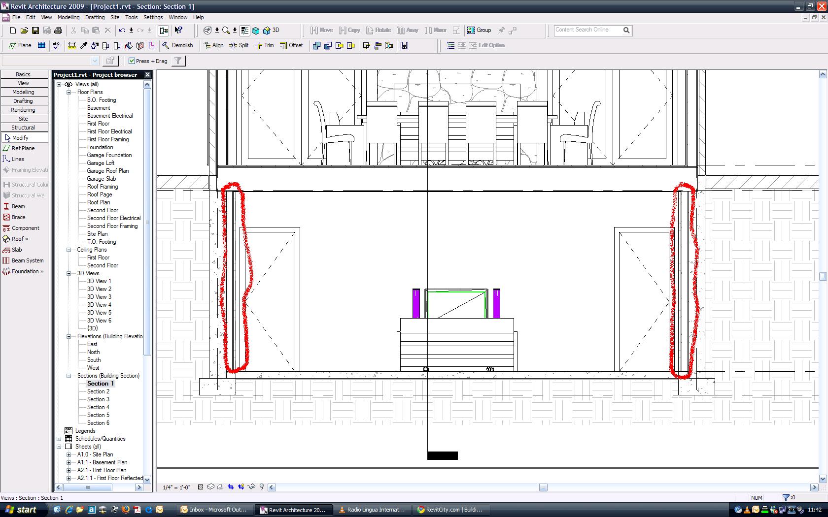

Old thread. Ok, my below grade slab still shows earth in the basement unless I put a "pad" of gravel below the slab. Since the pad only goes to the inside faces of the footing, the earth is showing up as slivers as shown bubbled. Should the basement slab be swapped out for a pad rather than a "floor slab"???

See my previous post.  Line the pad up with the exterior wall, then use the edit cut profile as req'd.

Also, if I understand the problem correctly, make sure you use the 'pick walls' method (exterior face) to define the footprint of the pad. Makes all the difference, especially coupled with the footing attached to the bottom of the walls.
I like the 'edit cut profile' way of finishing it off. Nice tip.

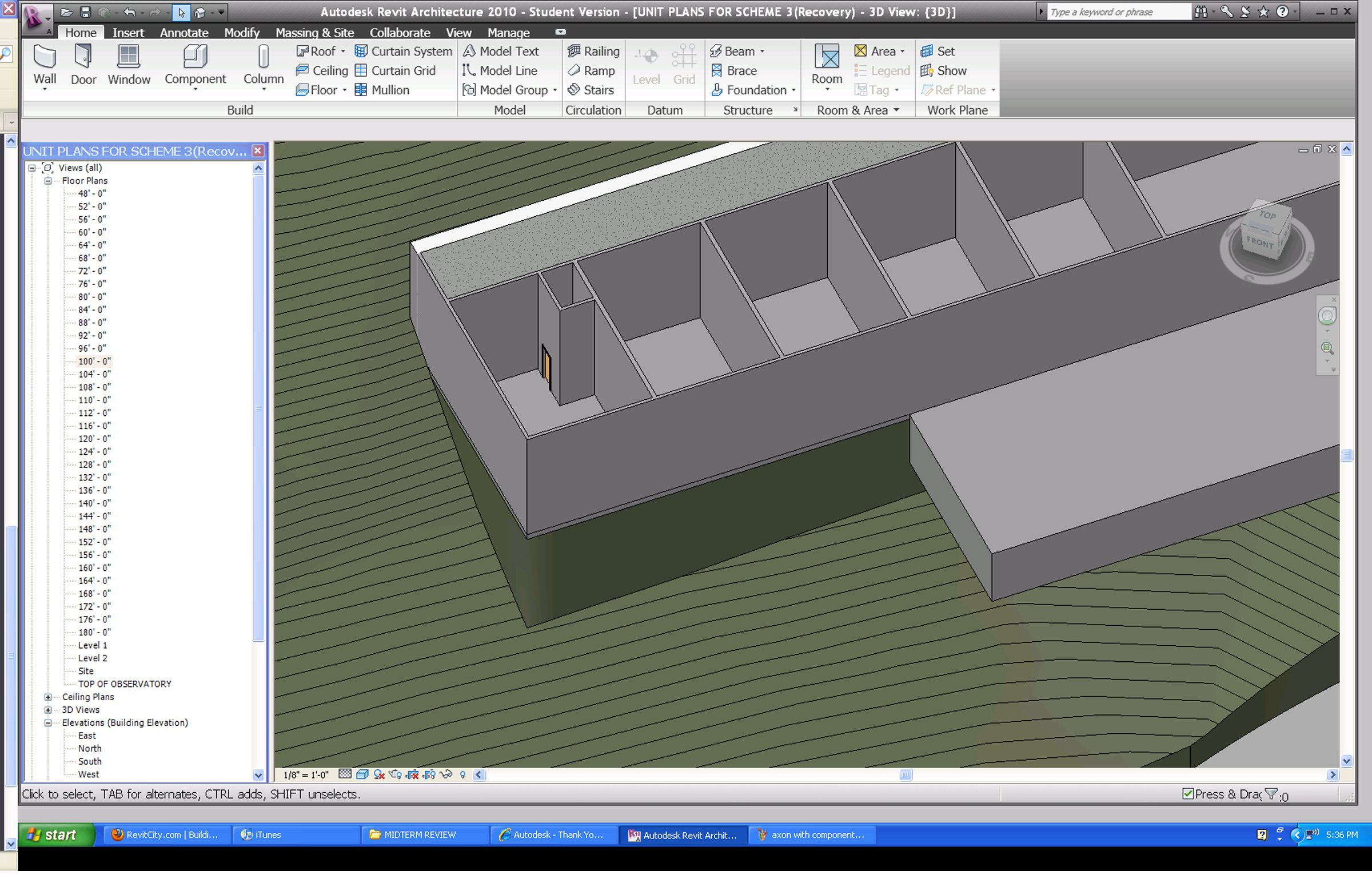

Hello friendly Revit Users,
I had an issue concerning the building pad.  I am working on a project where I am designing a building on a hill.  I had placed a building pad to cut away the topo where it placed a nice foundation for my building.  However, when I switch to 3D view, the building pad seems it is now being supported on a "fill" or the dark green area shown in my picture attached.  Is there a way to get rid of that fill so it appears as my building is being cantilevered from the hillside?

for some reason my bmp. did not show. hopefully this jpeg shows up..

If I understand your situation, try turning off the visibility of the pad. Either by category or by element. Most pads do their job but are never seen. Kind of like me : )

Thank you Daryl.  Unfortunately, I don't know how to go about hiding either the category or element (I'm a newbie - sorry!)

First thing you need to understand is Visibility display in generally is controlled 'per view'. That is after the 'object display' settings.
Here's two ways to skin this cat.
In the view type 'vv', then  scroll down to 'site', expand that catergory and turn 'off' the 'Pads' sub category.
or
In the view, click the pad itself (use tab if required) then clcik the Light Bulb under the 'View' panel on the top Ribon then 'hide element' or hide category'.
Use the light bulb at the bottom of the screen to see all elements or categories that have been turned off in the view.
Click the pink object and then clcik Unhide Element or Unhide Category as required.
